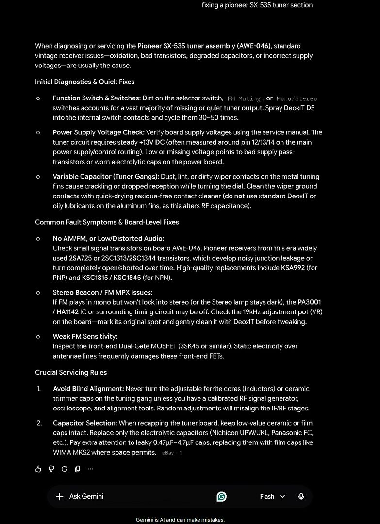

Well, I asked Gemini. I presume this is a Pioneer SX-535 tuner section...
