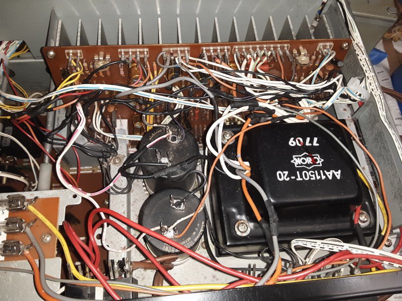

I just finished my first receiver repair that involved more than just replacing bulbs. My goal was to repair the unit and replace electrolytic caps as a maintenance measure. I thought I'd post my notes and some photos. I've learned a ton from AK since being bitten by the vintage stereo bug almost 2 years ago. It's about time I contributed. Note: I have more photos from this project. If you want to see anything in particular, let me know.
- I bought the receiver on that auction site for $25. Seller said the unit did not power on, no lights, no sound, cosmetically good though.
- I bought a hard-copy (i.e. legible) service manual with schematics. These were key since the circuit boards have no component markings or labels.
- I don't have a dim bulb tester (it's on my to-do list), so I turned on the unit and plugged in headphones. No sound from headphones.
- I removed the cover and checked voltage levels starting with power supply circuit. (I also noticed that this thing was a rat's nest of wires inside. Boo!) This photo shows the power supply area.
- I also noticed that amp board was wedged between the heat sink and the power supply. It would be nearly impossible to replace or check anything on it without removing it. This photo is a different angle, with heat sink at top of photo, power supply at bottom, and amp board in between.
- There was no voltage at the outputs of power transformer. So I removed the transformer, took it apart, and found an open circuit in the primary winding.
- Fixed the winding open circuit (soldered wire ends together) and reinstalled transformer

Here's a gratuitous shot of the innards:

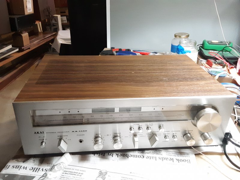

And a shot of the exterior with lights working. It's not a flashy receiver, but I like the aluminum face.

- Very difficult to get to amp board. It's tucked between heat sink and input power circuit.
- Had to cut many wires to remove amp board and then, of course, re-connect them later.
- No markings on circuit boards to indicate C1, or R10, etc. Schematics were essential.

- Love the look, aluminum face
- Nice big tuner knob that spins easily
