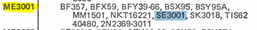

As part of this post, can anyone advise on the current transistors in the IF UNIT (UA1224K)? I replaced all the 2SC458's in the unit. As a result, the AM section works great. Found there's more than an alignment needed for the FM tuner. Very week signal with an antenna. Only have one good station around 88.5.
In the photo attached as schematic, appears the original transistor Qb1 (SE-3001) is not allowing signal to continue down the circuit. Cannot find a best substitute for a (SE3001(W). Additionally Qb2 (SE3001(R) appears to have been changed. Number on this transistor is GE39. Again did not find if this is the correct selection or number to cross. Unsure what the (W) or (R) suggests? I just know the one with (W) has a white paint dot on top. Please review the photo for more details. I confirm I tested on the CB for now, prefer to have a replacement and change at same time. The main concern are the E, B, & C do not agree with the typical Kenwood symbol on board. Not sure if just mislabeled or someone installed wrong?
Is the ME3001 a correct or best selection?
Photo in yellow are compliments of another post sent prior. I followed it and AM section works great. Just unclear why the reading say different on the UA1224K?
