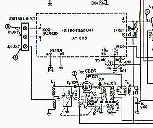

What I did find is a 270K resistor in parallel to ground across the 0.01 cap. As part of this troubleshooting I measured the voltage at pin 2 of the filter T6 in the schem above. It swings between 0.0V and -9.0 on the pin. However on the opposite side of the 2.2M, it drops to the sub -1.0v range. When I remove the 270K, I get as much as -4.5V and the eye fully closes on FM. Between stations the eye only recedes back about 30%.
Not sure why this 270K is in circuit???
Any thoughts on improving the pin 3 voltage beyond this?

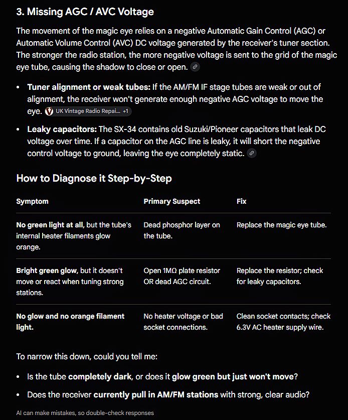

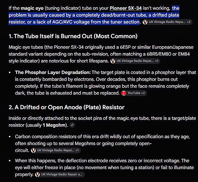

I Googled this. Maybe it'll help. :idea:
hm, there isn't a 270K in the Pioneer schematic, but I suppose there could be a difference on the Allied schematic. 2.2M into 270K is going to significantly alter how much voltage gets to the eye tube grid, which will of course affect how it responds. Unless the circuit is supposed to have a lot more voltage swing than the eye tube wants, I'm not sure why it would have that.
other thought, if they use different eye tubes, the response is different. 6E5 needs a lot less voltage than a 6U5 does.
Possible the tuner gain is poor, that will result in low voltage getting to the eye tube grid as well. Low voltage would do that, may want to see if the plate and screen voltage in the IF strip is reasonable. The IF parts are common so if its not right on AM or FM, guessing its going to be a common factor.
I found this schematic of the Pioneer SX-34B tuner section. See if it matches your Allied receiver's section.
The voltage out of the coupling transformer T6, Pin2 goes as low as -10.VDC. The drop across the 2.2M and the 270K 9Before I took out of circuit) dropped the voltage to sub -1.0VDC. Probably a combination of issues. Per Rwoods post - above - I don’t get 242V on the 6E5. The max is about 205VDC. May need to hunt down this difference.

I'd pull one leg of that 1 meg-ohm grid resistor (circled 3-point, on the schematic). Measure it. Hopefully, it's that simple.
If it's off by >20%, I'd replace it with a good metal-oxide resistor.
