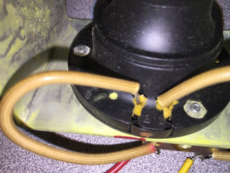

I got a pair of Altec 3000G tweeters that have red cable connects to terminal 2 and yellow cable connects to terminal 1 (see attached picture).
I am confused with which terminal is for the positive (+) lead and which terminal is for the negative (-) lead.
Any help would be greatly appreciated.
Thank you!
I'm not sure of the polarity but I can tell you that they have a fairly low power rating and can be damaged very easy. The diaphragm is actually out of Altec's microphone and is no longer available. The Altec 601 coaxials used this diaphragm in there design. Sadly a lot of the 601's on the market have a blown tweeter section.

Terminal 2 is the positive.The one on the left in this picture.If you look closely there is a red paint mark by the #2 terminal.
Thanks for all the responses!
I think I have learned a lot about Altec speaker polarity in a day. Terminal 2 for + lead it is then. :)

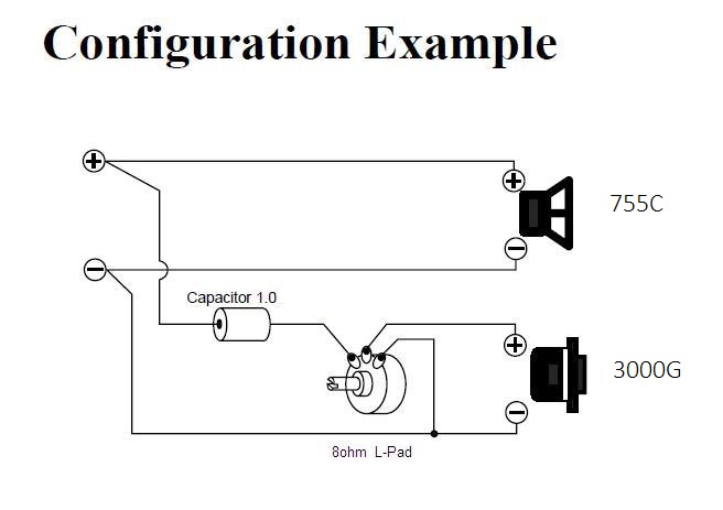

Btw, the 755C will be run at full range and 3000G will help out on with the upper frequency. I borrowed this sample diagram from Lowther site which is originally for its T90A tweeter.
Hopefully the 1 uf cap and the 8 ohm L-Pad will provide enough protection for the 3000G tweeter?
Thats a pretty high xover point. Something around 20khz. You will not have to worry about blowing the tweeter but you also might not get a lot of output. Maybe if you crossed it at 10khz with a first order xover it would still be safe and have good output.
Since you are running low power tubes instead of SS you can get away with a 6db slope and not have to worry about tweeter damage.
Hi elitopus, I thought that 1uf cap will cross at around 10khz. What value shall I use for crossing at 10khz? Thanks!
3000 series tweeters are nominally 8ohm.
However, the only impedance that's important will be the actual measured impedance at the intended crossover frequency, and that will be anything but a nice even number like 8 or 16. To begin to do this right you MUST know the impedance at frequency, or have the ability to measure it.
Also consider that a 6db/octave filter at 20khz is only bringing the signal down 6db at 10khz, 12db at 5khz. That's a lot of signal in the audible range still making it thru.

All wise advice...but I would go ahead and wing it with a 1.5- 2uF cap (8 ohms). You'll be OK with a 300B SE amp played at normal levels. Wisdom only gets you so far.
The extra overlap provided by the 2uF first order cap will enhance the leading edge definition of the 755C nicely.
If you use a 1uf or maybe 1.5uF cap on that 8 ohm tweeter, you might find that there is no need for an L pad because the tweeter will be rolling off already where the 755C runs out of action.

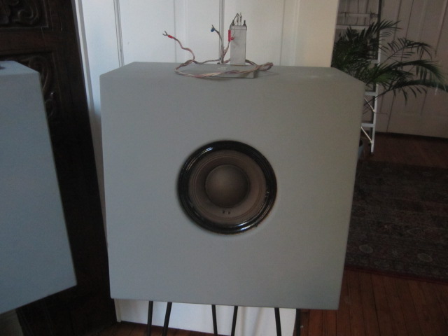

Here's a pic of my 756Bs with 2uf WE caps on top, wired and ready to go, waiting for my tweets!!
If the sound blows my mind, I will permanently install the 3000s in the cabinets.
I am not worried about my tweeters at all with 300B and soon-to-be finished 275A single amps.
