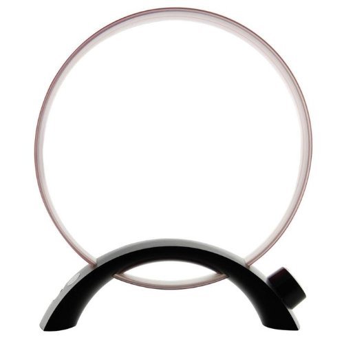

Take a look at a magnetic loop antenna for AM Broadcast reception this is one from Grundig. There are others with more-or-less the same design. Note the antenna trimmer on the side this makes a huge difference.

The Terk & the "Grundig" shown earlier are broadly similar and probably of equivalent performance -- and that level of performance is indeed pretty good.
http://radiojayallen.com/select-a-tenna-vs-terk-am-advantage/
The Select-A-Tenna was a good, relatively inexpensive tuneable AM loop -- they're no longer made, but it shouldn't be too hard to find one at a hamfest, antique radio fleamarket, or even on eBAY.

The AM loops, of course, have their antenna wire coiled in... well... a loop. This isn't just for compactness -- there are electrical properties of a properly made coiled loop antenna that are exploited by the Terk, the Grundig, and the Select-A-Tenna... but explaining that concisely & accurately is beyond my pay grade :-)

The AM loop antennas are great for finding different AM stations far from your location because they are directional. By rotating them around you can discover all types of different stations, especially at night when "skip" occurs. My wife enjoyed to listening to Ireland in the wee hours!
