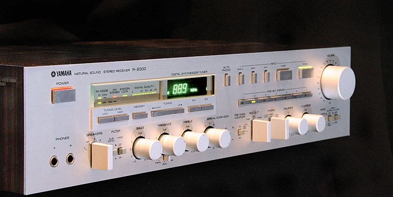

I know the Yamaha R-2000 is already on the list, and has been mentioned in the thread, but I thought some photos might still be in order :thmbsp:
