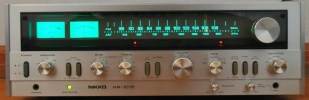

Hi everyone :beerchug: Caught the audio bug about a month ago & feel lucky to have acquired some mint Dahlquist DQ10 speakers in custom red for the anchor piece & a Nikko NR-1015 receiver last week! Can only say I have been hearing things I have never heard before:music: .
I am amazed at what the 85wpc NR-1015 brings out in the 8Ω DQ10s (especially the base, that loudness button is wild) but have decided that I need to give the power hungry beasts what they deserve. I am looking to use the pre out to add another high wattage amp but need your help in narrowing down the list below OR tweak based on your wise audio karma insights ?
What would you RECOMMEND? isn't COMPATIBLE? PRO TIPs? or AVOID?
(easy on the placement I am working on stands to bring em out farther)
My EAR Situation & Preference:
  • I am on a budget with a priority to bring the best warm sound & performance out of the DQ10s but don't haven't listened to enough systems to know the synergy nuances. I've read that you don't need an amp with super high wattage amp for DQ10's but you DO NEED one with very high peak amperage capability.... I don't know what this means tho:rflmao:. I have a little flexibility of spending more, if significantly better in your experience.
  • I listen to almost everything but really appreciate some vocals, strings, jazz & heavy beats.
  • Hi-Fi is key but the amp needs to match with the setup aesthetically or it will bug me. You can see my place is a little retro so steel is the vibe and who doesn't like meters?
  • Just beginning my journey and don't have a lot of technical tinkering skill or time, so low maintenance is a factor for me.
  • Next goal is hooking my tv (via bluesound or ...) to the setup so ideally the amplifier would easily integrate.

I am picking up the Nikko Alpha 1 on Sunday !!! :banana: !!!
2nd choice was the Phase Linear 400 (with plans to a due a White Oak update) and the Sansui B2102 but the Nikko had more power and matches my Nikko NR15, is a lot closer to pick up, and is just more rare when the masses find out about the under the radar Nikko quality . If there are any Phase Linear or Sansui folks who see this and think I am overlooking something, I would love to hear your thoughts?

Awesome! I restored one a while back that had blown an entire channel. Only preventative maintenance on these is replacing the protection relay, LY2-02-DC24 I believe. Make sure the huge cap caps aren't leaking too, I replaced them with UCC 33,000uF 100V 3" I believe.
You'll love it. Now find a Nikko Beta I!
NR-1015 is a superior piece of kit. I had a local tech repair mine - and he tore it apart once he saw what was in there. He was impressed by the tuner and, no idea what I had, the phono pre-amp. I bought it on a sale from a place going out of business. Worthwhile investigating what you can do with the rig regarding vinyl reproduction.
My FM tuner isn't currently working and haven't tried the phono yet but this is good to know. The insides need a good cleaning but I haven't investigated too much as I have only had it for 3 weeks and loving every bit of it soo far.
How would you describe the sound? My dad thought it was a tube amplifier when he first heard it?
I still have an NR-1015 and it is one of the best under the radar receivers from the 70s. I have owned most of the monster receivers from Marantz, Pioneer, Sansui, Sherwood, etc and it holds its own with all of them. The Nikko Alpha 1 is a great amp. I really liked my Alpha 1's I had years ago. The only drawback to the Alpha 1 is it did not have a power switch but it was to be paired and switched with the Nikko Beta 1.
The Alpha 1 is an excellent match. I stripped the vinyl covering from the NR-1015 case and used some nice wood veneer on it. I'm not a carpenter but it wasn't too hard to do since there aren't any real difficult cuts with the NR-1015 case. If you wanted a deeper blue color with the dial lights, you can easily and quickly swap out the lights for white LED's which will give it a deeper blue look.

Yeah, it is currently driving my main system (DQ-10 and surrounds) with a powered subwoofer in my living room. The 85wpc has more than enough power and sounds soo good. Some expenses came up so I couldn't pick up Alpha 1 just yet, but it makes me wonder how much better the DQ-10s will sound with more than current 2x wattage.....especially since I don't blast my music. @milo63 mentioned that his Alpha 1 "really woke up" his Dahlquists but unsure on the science behind how more wattage creates higher fidelity in the DQ-10's at low to medium volume. Think I am going to have to bribe him to come over for a test :naughty:
Could sure use the funds to renovate the Nikko to 100% an ensure it lasts..... or maybe a tube receiver ( I hear the DQ-10s pair really well with tube amps).
