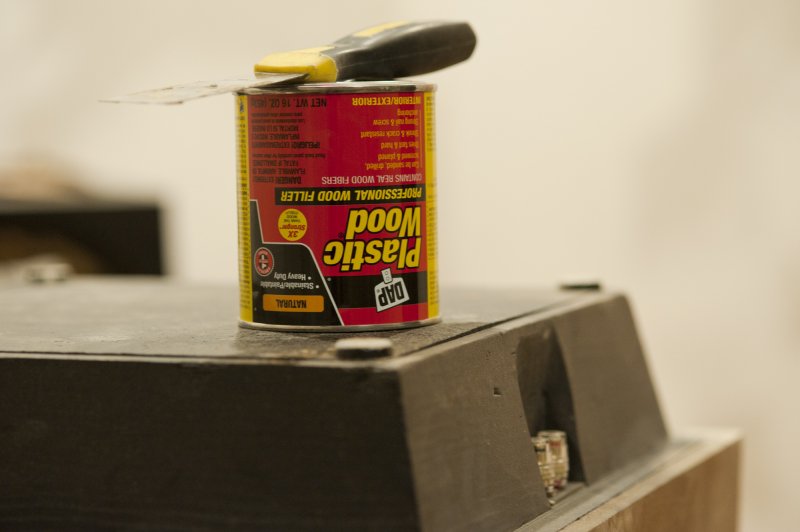

Got the urge to finish this project. One cabinet is veneered and trimmed, but not finished. The second cabinet's corners are almost sharp. I should have the veneer done this weekend. Here's a few new pics of the progress:
In the meantime, a friend of mine gave me his old HH Scott LK-150 tube amp. I'll soon be restoring that and using it for bi-amp duties in this AMT-1a, and also for the Transar. :music:
If you find a successful way to blend the color of that filler, post your methodology. That may one of those art forms that take a lot of practice to develop, like matching paint in automotive.
Mix up a "Toner" to match the Walnut color. Use an Airbrush or small paint brush to
apply it over the patch. You could even simulate the wood grain with the small brush.
I use alcohol based stains as they are concentrated and are compatible with Lacquer and water-based coatings.
My 1B's had the same damage as your's. I watched the UPS Doofus drop the box off the tailgate of the truck right in front of me.
Good Luck!
Good Luck!
I tried using a dye a tint or two darker than the original dye, but was never entirely happy with the end result. On the good side, the small dings I filled disappeared under the 1/4 inch of poly coat I've put on. I think maybe next time, I'll try mixing some of that muscle man water putty with a combination of water and dye.
By the way, I hope you're not making the alcohol dye from the dregs at the bottom of the still. It'll make your Heils go blind.
I'm not going to tone the wood filler because, like you, I don't have the medthod. I'm using the filler to form a tight angle at each corner so that, when I put the veneer on, there won't be a gap that gets caved in. The veneer goes on tomorrow. The parts that show that are not covered by veneer will be painted black. Better pics when I'm done.
