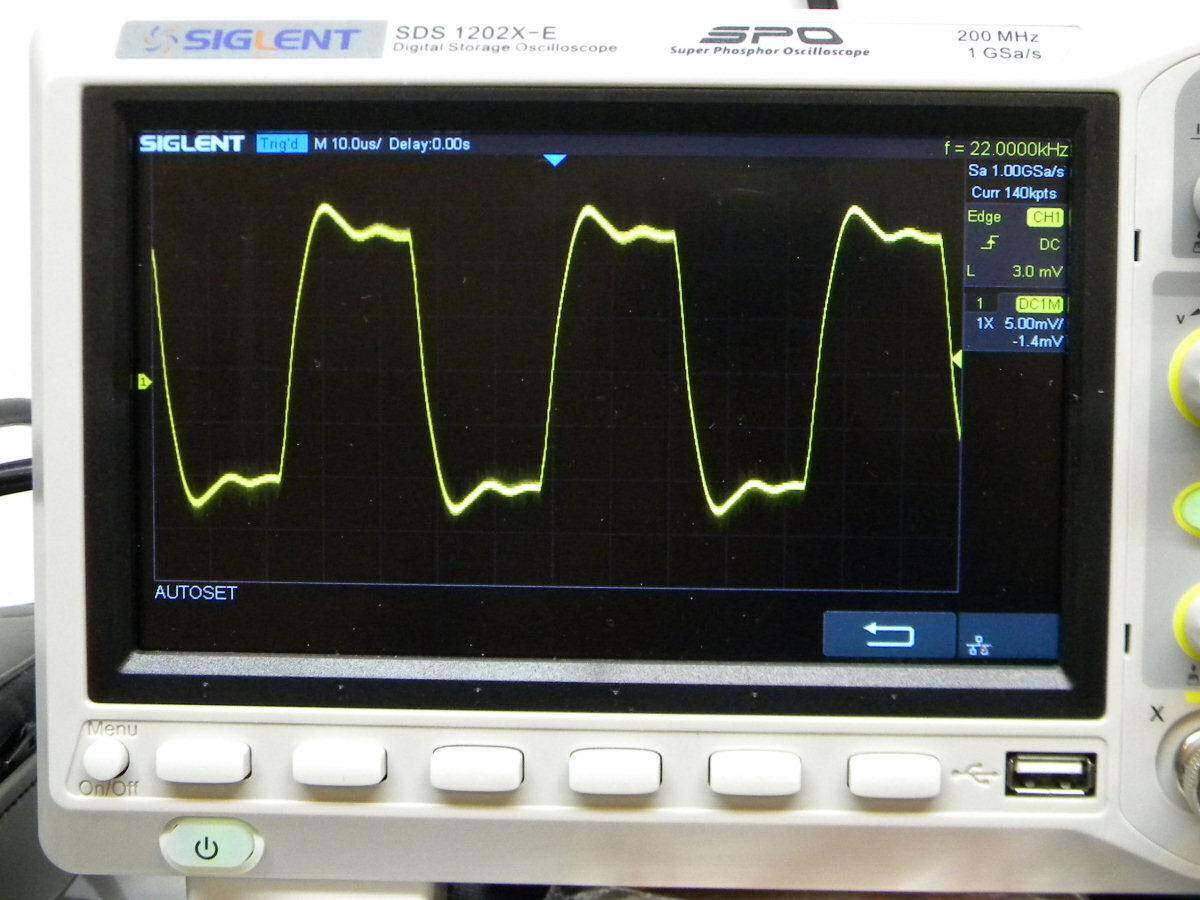

Does anybody here have one of these (or used one):
Siglent Technologies SDS1202X-E 200 mhz
How happy are you with it?
Any major problems?
I am looking at acquiring a 200MHz scope and I am torn between a new one with modern bells and whistles, and an old Tek 475 analog I would be completely comfortable using. They are about the same money, for a good calibrated 475. But the Siglent has more capabilities, and learning curve . . .
FWIW, I can't see buying a lower bandwidth scope and being happy with it, long term.

The 1202X-E can do X/Y plotting, but the setup is through soft keys and not a switch/range input which is what you might be accustomed to with the Tek.

I’ve been using a SDS-1202X-E for audio work for some time. It’s been working as expected. The X-Y function also works fine.

I used SDS1104X-E. It's OK for audio. Currently using SDS2204X Plus. 10bit resolution makes quite a difference. I also own Tek 2247A and the venerable 2465B 400Mhz. Most of my audio work I did was on 2247A due to convenient and fast "smart" cursor auto-tracking. 100Mhz was more than enough.
Siglents have X-Y, it's in Acquire menu. I did Lissajous on both siglents, and 2204 draws a line sharp as a pencil, while 1104 struggles.
