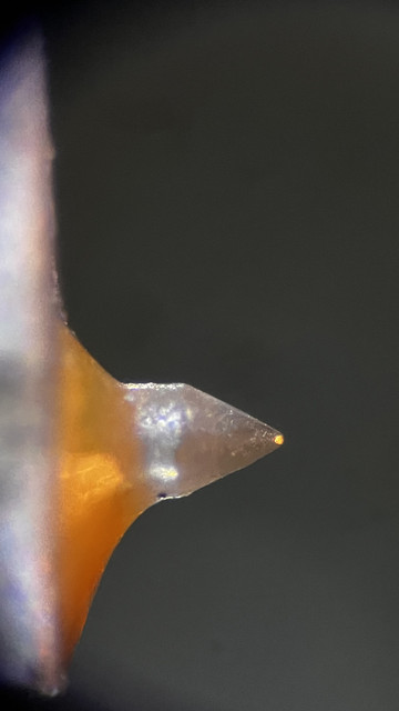

The cartridge came with an original Empire stylus (brown), which it's a hand polished spherical (same as nude conical??). Unfortunately it's worn. I'm sharing some images with you:
I think I should invent a stylus with ratchets that can be clicked and rotated in 45 degree increments and get four times the wear life!

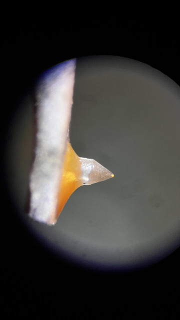

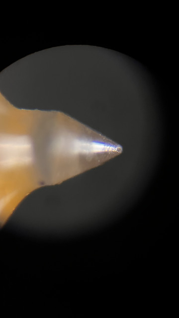

Here are the best shots I could come up with on a Saturday night that involved shots of another kind. It appears to be a bonded Elliptical, but in decent shape although hard to tell if there are any minor wear issues. It needed more cleaning as well, but a little more solvent and a gentle stylus brush greatly improved its appearance.
The head shell I mounted this on is a Technics OEM purchased from Rivertone. I've purchased a few because I've run the cartridges mentioned above, which came attached to the junker SL-D's I've restored on head shells with cracked/damaged ring washers, plus I've added the VM95-ML and a Grado M+E for my stereo and mono listening pleasure.
Now that it is cleaner I'll give it a fair comparison to the VM95-ML at proper VTF. But going for the JICO might be the respectful course of action to enable the best intended performance of the original.
BTW that is a very fat cantilever!
PS-Looks like I need to brush it a bit more to get rid of that lingering fuzz. Maybe it was stored in a knitted sweater or something.
