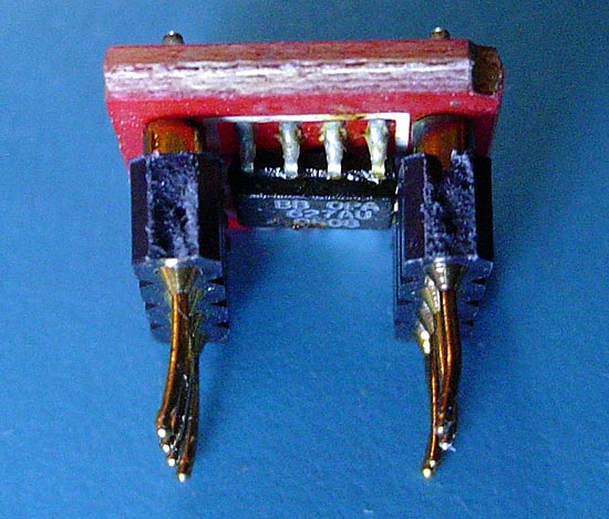

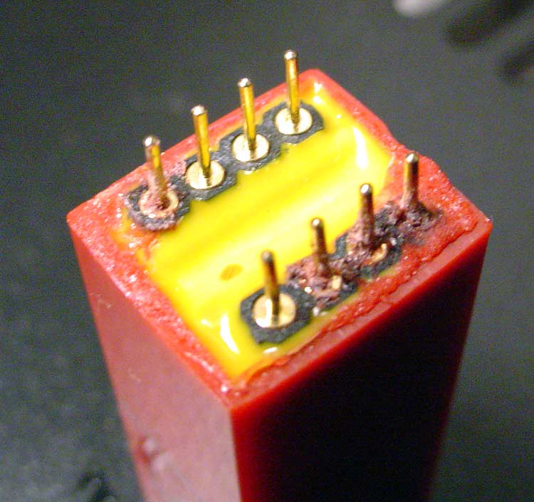

Here's a couple pics of the first failure ...

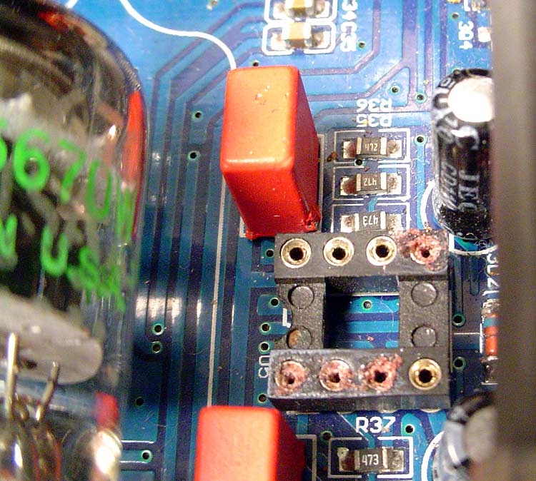

I'd think a lot of it was heat related as the socket is really close to the tube. Not an issue with the browndog OPA's as they're much shorter and don't get anywhere near the glass. The "corrosion" may have been the epoxy melting and leaking? It didn't get on the board, and the socket cleaned up decent anyway.
One other interesting (mutter mutter) moment came when swapping back to the browndogs - the pins on the Burson were bigger and had spread the socket holes to where the browndogs were really loose. I ended up bending the legs on one for a tighter fit, and that got me up and going again.

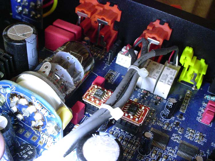

Socket is now replaced, and the OPA's are in place ...
it's safe to say I'm done screwing with high end analog op amps. Your results may vary depending on your DAC, but I wouldn't recommend them for the Mavs due to the tube's proximity. If you DO decide to try em, I'd also add a 90 degree socket extender to get some distance between the tube and op amp ...
I have a feeling that was it--whatever the Bursons were potted with had leaked out. I was only wondering if the Burson op amps were generally unreliable, but now I see how close it is to the tube. I don't really have a use for upgraded op amps in anything as of yet, but I've still kept them bookmarked for future use. :thumbsup:
