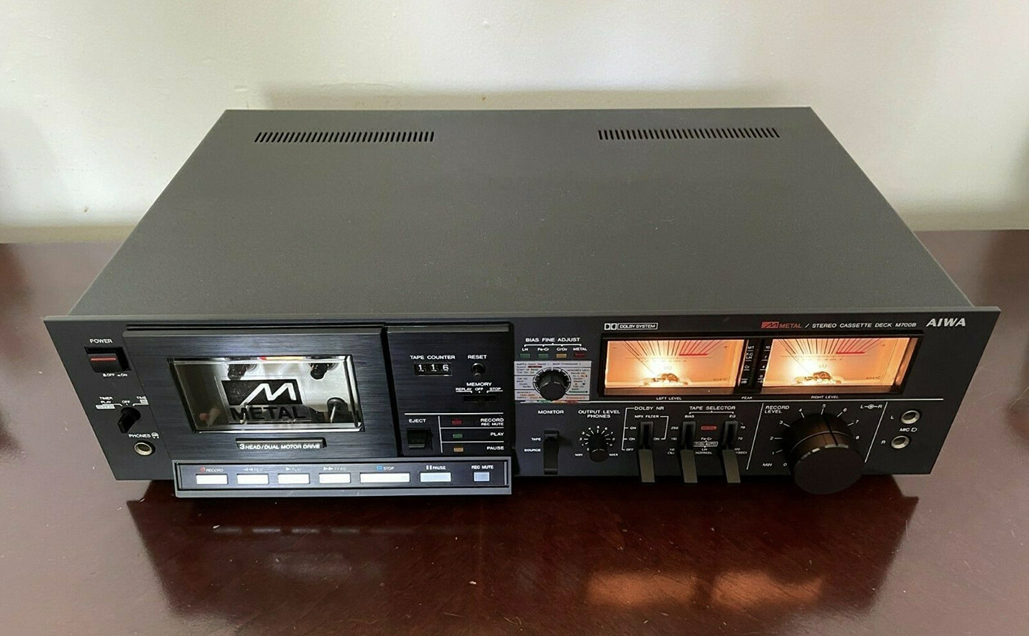

The Aiwa will be interesting because it has more Dolby NR options and it's bias fine tuning adjustment that lets you select each brand of tape.
I'm not sure home much of a gimmick this setup really is though. Apparently it's supposed to light up depending on which tape type is being optimized. I'm not sure if this is just a normal bias knob with a fancy sticker or if Aiwa actually optimized each adjustment for each brand of tape and the deck knows which brand you are playing. I'm going towards the former but I need to do more research.
This model the AD-M700BU black model. I will tell you it looks very nice and am anxious to hear if it sounds as good as it looks.

I'm still kicking myself for not picking up one of the nicer AIWA's years ago when it was a couple bucks but I only had room for some many full size decks. That's a nice looking deck Shakedown, AIWA is one of my favorites, my old neighbor and one of the smartest people I ever knew, always told me AIWA Tape Decks were super nice so I picked them up when I found them.

The single knob bias control is a marketing item and they rarely did anything accurate or good- most all of them are a joke. Even on Nakamichi decks they brake due to cheap pot and it is just better to use the internal adjustments and not fool around with gimmicks. The deck like the Teac/Tascam C-3RX, 122 Mk II and Mk III do have real external left and right adjustments for bias and levels the way they should be made.
