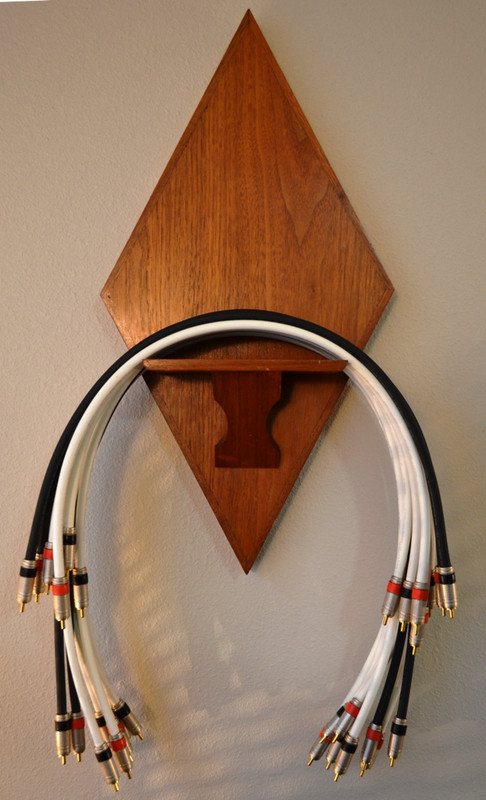

I made my own phono cables using the Blue Jeans LC-1 cable (12.2 pF/ft - black) and some Canare F-09 connectors. I cut down a pair of 10' LC-1 interconnects and made 2 pairs of 3' cables and 1 pair of 2' cables. I also made 3 pairs of 3' and 3 pairs of 2' interconnects from a pair of 15' Canare LV-77S (21/pF/ft - white) interconnects.
I'm really happy with way they turned out. I use the LC-1 cables for my turntables and the LV-77S for everything else (although they could also be used for turntables in a pinch as 21pF/ft is still reasonably low capacitance). My Harman Kardon T60 originally came with a pair of "ultra low capacitance" phono cables, but they were long gone before I got it. I figure these LC-1 cables are as close as I'm going to get to the originals.
