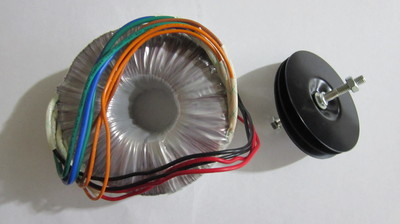

I have the classic B&K Ex442 amp (not the Sonata), I love this thing, sounds very good and smooth / I never owned a tube amp, so I can't compare, but people say it sounds tube like / I just replaced the original Caps (that made a big sound difference) in quality, richness, sound stage, it wasn't small - ya the Caps were old, still working but old.. then because I upgraded the caps from 17,000uf to 22,000uf per cap each / I also upgraded the old rectifier bridges, better, newer with higher voltage rating...

the transformer hums / it goes in and out, will hum for a while and then stop and not hum, I havn't measured it or anything to see if the pattern is random or exactly the same..
Now here is the Question, should I spend $120 on a DC voltage blocker device (maybe this is it), or just spend $100 on a new transformer ?

it hummed with the old (capacitors) then new capacitors (old bridges), and now with the new bridges it hums too.. so thinking the transformer needs to be replaced ?
Oh, well that's something else entirely then. I'm sorry to hear that. I was hoping the issue had been brought on by the work you did which would make it easier to backtrack to an earlier state where it was silent. Hopefully someone else will chime in with a solution. One thing to check is make sure the transformer is properly tightened down and that you aren't hearing a mechanical vibration because it's mounted loosely or has worked itself somewhat loose. See if you can put your hand over it and squeeze it or push it down with your hand if you can make the hum temporarily go away. Good luck.

When I first opened it up to upgrade the capacitors / it was all loose, the bolt that was holding it down was stripper around the metal washer at both the bottom and top, because it would rotate overtime and it wasn't holding it down for sure / I replaced the bolt with a new set and tightened it down much better than before, I think it is super secure / but I can try the push down when it is open next time... but this is why at this time I am thinking a new transformer.. ??
maybe it need more rubber washers ?

If you can determine that applying external pressure quiets it down tells you one thing (and you may be able to fix that), but if that makes no difference you are definitely looking at new parts. The transformer windings can de-laminate themselves from within and generate a hum that will never go away if that is the case. If you're lucky, you may be able to tighten it externally somehow. I would say the new rectifier bridge may have caused it, but we know that isn't the case since it hummed before -so it's nothing "you did".

I figured it out, its fixed... when I was replacing the main stripped bolt and nut / somehow I put the bottom rubber gasket on the outside of the amp, lol / maybe I was drinking a beer that time, I put it inside the amp on top of the metal bottom bracket and the hum went away, its been now a few days and I don't hear anymore.. finger crossed, I also put an extra rubber seal at the top too and extra tightened the nut...
