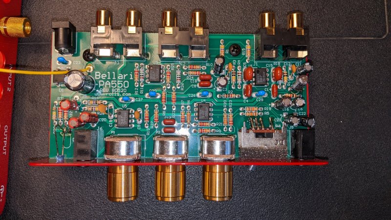

For now, here's a picture of PA550 internals. Looks like they are using JRC op amps - a solid if low cost option. Love the absence of micro components -- only normal sized circuit board components. Hopefully hardier, and also easier to fix if something breaks.
