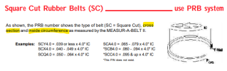

Did you try to look here. They seem to have a large assortment of sizes.
http://www.russellind.com/prbline/prblinecom_.htm#
Measure the belt length (with a piece of string, or the old belt), subtract a bit for tension, and you have the length that you need. Then compare it to the dimensions in the table. See if the table above corresponds to your Advent deck. I don't know about the ST.815?
