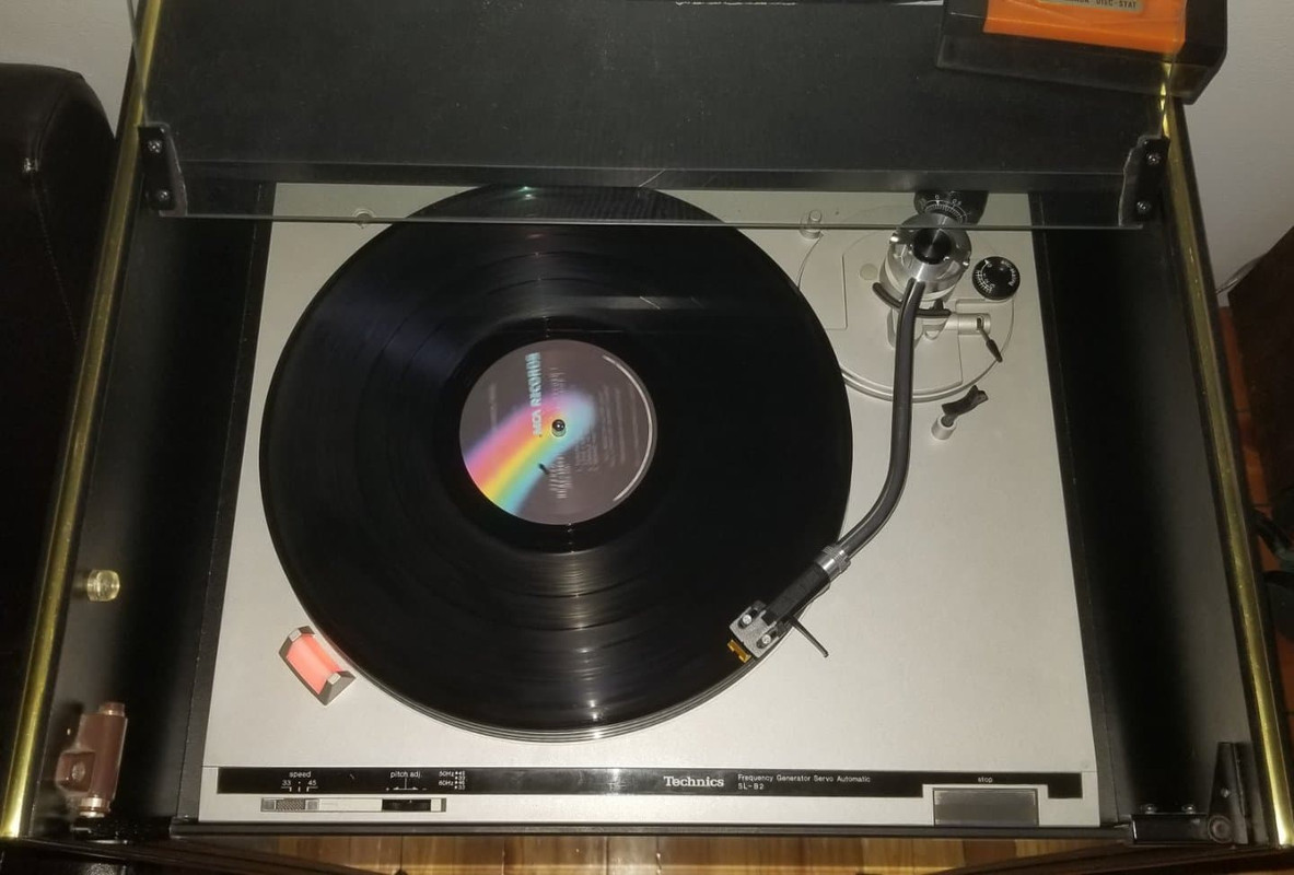

I recently purshased, for very cheap, a Technics SL-B2 that didn't work that well. After some touch ups, it runs alright, but it's not exactly perfect. It sometimes need pitching assistance. But it's runnable.

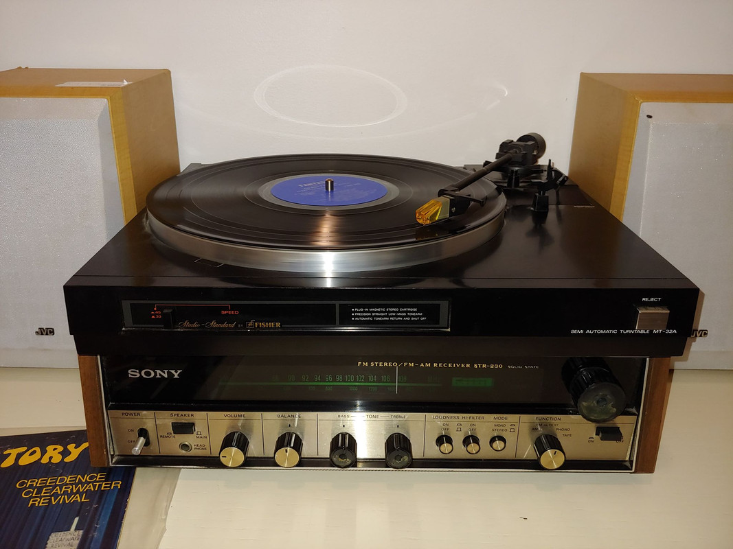

Now I needed a second turntable for the dining room, and I brought home a free Fisher Studio-Standard MT-32A. It was broken, I made it run, it's alright now. Super cheap TT and sounds better than it looks... I'd keep it as a backup or I'd give it to a friend.

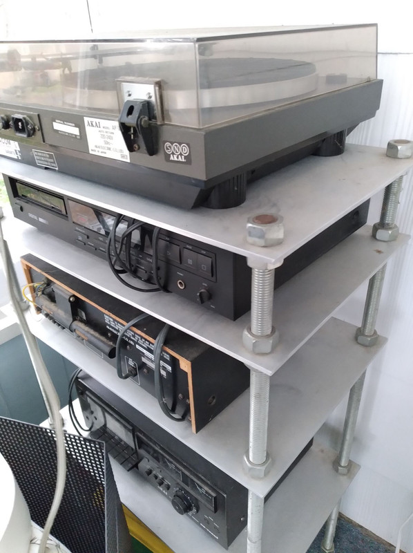

All while setting up my stereo systems in my new appartment, my mother sent me this picture, asking me if I wanted this TT. I suspect it's an AKAI AP-100, but I don't see the whole thing on the photo.
So, basically, I'd have all of them for free. In this case, I will definitely try to get my hands on the AKAI (and also the rest of the sound system too). But I wanted to know a few things.
First, is the AKAI the superior model (higher-end) compared to the Technics? I do know that the SL-B2 was the entry-level of Technics. But I don't know anything about AKAI and how their line works. As for Technics, I got to know a little about their models.
Second, are AKAI generally regarded as a good turntable brand? I do know they made good tape decks, at least that's what I read on here. But there isn't much information about the TTs. I have seen the reviews of both TTs on another website, but all in all, most reviews are positive for both.
Third, it might not work anymore. How much would be too much to spend to get an AKAI AP-100 to work?

Akai never built anything even close in quality to a SL-1100, SL-1200, or SP-10, SP-15,or SP-25. Your Technics is a decent, but basic turntable and belt drive with a DC motor. The Akai your Mom offered you is in good order, a nicer turntable than the Akai you have, and an upgrade to that. I'd get it. In good order, might be your best turntable of what you have. Likely has an AC motor which will be more reliable and maintainable than the Technics DC belt drive motors.
Technics SL-B2
Specifications
Type: semi automatic
Platter: 304mm aluminium alloy
Speeds: 33 and 45rpm
Motor: servo controlled
Pitch control: 6%
Wow and flutter: 0.045% WRMS
Rumble: -70dB
Tonearm: static balance, tubular
Tracking force adjustment: 0 to 3g
Effective length: 230mm
Cartridge: EPC-270C moving magnet
Dimensions: 430 x 126 x 375mm
Weight: 4.5kg
Akai AP-100
Specifications
Platter: 300mm aluminium die-cast
Drive system: belt drive
Motor: 4-pole synchronous motor
Speeds: 33.33 and 45rpm
Wow and flutter: 0.05% WRMS
Signal to noise ratio: better than 53dB
Tonearm: Static balanced type with inside force canceller
Effective length: 220mm
Overhang: 15mm
Both tables are belt driven and I would choose technics due to slighly better spec, pitch control and strobescope which akai lacks.
So, basically, what you are both saying is both are entry-level turntables, but the Technics has some better equipement like the pitch control, the stroboscope, which I am very fond of. But it vould be a more decent 2nd turntable for the living room than the Fisher Studio Standard, I suppose?
Yes, the AKAI would be better. Even though the Technics might look slightly better in the specs, I would almost prefer the AKAI.
Well, I do have an issue. It's a Swiss turntable, and I'm in Canada. It's meant to be played on 220V-240V / 50hz. When I play it on a 220V / 60hz. It plays at the right speed but I am not sure it's durable. Also, the motor doesn't always stop spinning after the tonearm is back into the cradle. It stops sometimes, but not always. I noticed that if I stopped the platter with my hands, then the motor will stop spinning.
Well it does play, at the right speed. For the moment, with just a belt and oil in the right places, it's been playing okay. I don't know how long it will run as a 50hz table playing on 60hz though. I can't seem to find why it's still spinning sometimes after the tonearm is back to the cradle. And It does seem like the stylus/cartridge might be up for a change.
