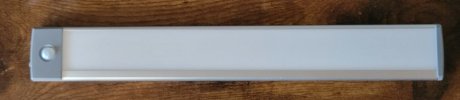

I used LED. LED in my big lighted magnifier, and thin LED light bars under the shelf above my bench. The thin bars are rechargeable, and clip into magnetic mounts. I can easily unclipped one and use it by hand too if needed.

Inrecently installed those 4' LED light bars in my garage. I like them a lot better than fluorescent lights. They're also cheaper. I held one over my bench, but it was too bright.
These are the around 12" light bars I put at my bench. They cab be switched to on, or motion activated. They're light weight and clip magnetically to a couple metal clips. They're rechargeable by USB.
The light is softer than the LED lighting in my bench magnifier.
