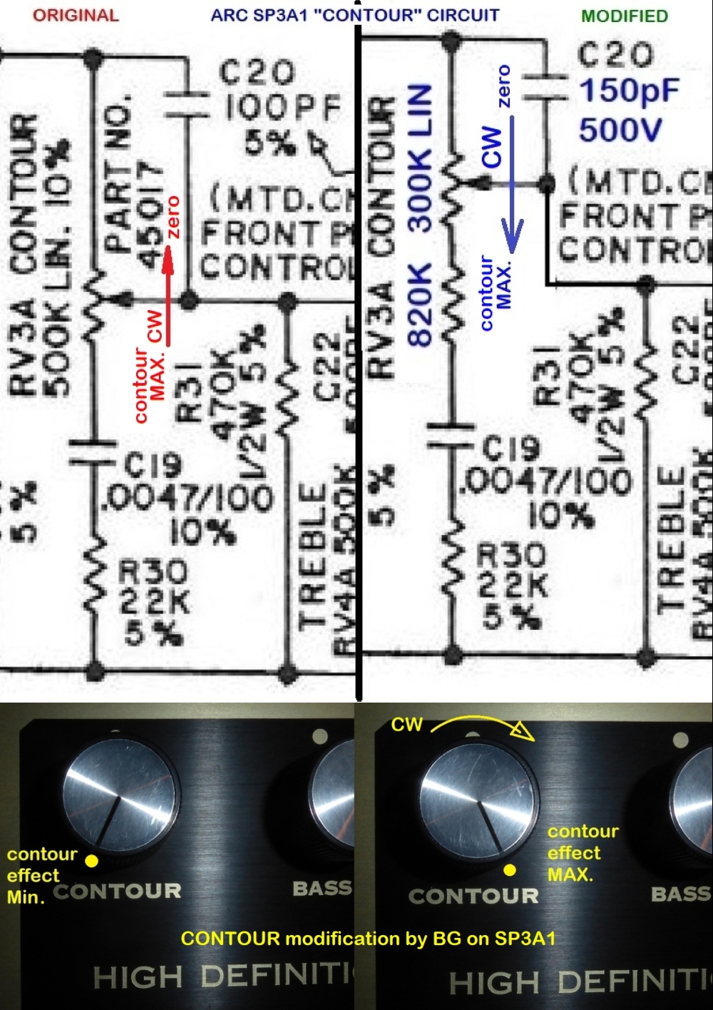

I modified the Loudness Contour on my Audio Research SP3-A1 : the original pot was dead, so it was the occacion !
Smoother, deeper and much more progressive effect is now provided by this modification... Plus a conventional sense of operation of the pot !

@tubelectron you can’t just bomb in here and show a nice upgrade to the ARC contour by schematic and not tell us what sonic differences it is from stock. Knowing more might have us upgrading, too.
I say this because it is a great control in stock form for my systems using it with just a bit of activation for normal listening. I usually run the knob, noon is off, ccw adds contour at about 10:30-11:00 for just a bit of boost on both ends.

Yes. First important point, @Blue Shadow : the original Loudness CONTOUR pot of my SP3A1 was cut on one section (I re-read my notes), so it was not working properly - at least on one channel.
* That said, here's what I observed with the original contour circuit as is :
1 - the sense of operation of the contour pot is not conventional, but this is the normal operation of that control, according to the SP3A1 manual : minimum contour = maxed pot. You back the pot setting to allow contour effect. This is not my taste, but if it had worked correctly as is, I probably would not have modified it.
2 - when maxed, the contour is roughly neutral, but with a significant and constant drop in volume, compared to TONE off.
3 - backing the pot setting increases the contour effect as expected, but only once the noon setting was reached. From full CW rotation back to noon, there's no noticeable effect, except the constant loss of volume (as mentioned in 2 - )
4 - once noon reached and going CCW : the contour effect appears and increases, but around 9:00, the effect becomes too heavy in the bass and doesn't change too much further. Roughly, the useable section of the contour pot as is is from 9:00 to 12:00.
* Given that the original pot was damaged, I took the occasion to cure and modify the contour control :
1 - shifting the control to normal sense of operation : maximum contour = maxed pot.
2 - nulling the volume drop when the control is zeroed, and absence of effect, compared to TONE off mode, allowing the use of the tone controls as if the contour was neutral or defeated. (820K additional resistor).
3 and 4 - regularly spreading the effect all along the travel of the pot, from no effect to max, and limiting the setting to the useful portion. (RV3A 2x 300K LIN instead of 2x 500K LIN).
5 - increasing the value of C20 from 100p to 150p 1% silver mica, to give a tad of brightness when contour is increased.
* What are the sonic results ?
- normal sense of operation : CW = incrrease of the effect. More practical to me...
- contour effect defeated when zeroed : no loss of volume, no perceived effect (or negligible), leaving to the tone control all their possibility of action.
- easier and progressive control setting all along the travel of the pot.
- no setting-useless part of the travel of the pot.
- slightly better balance in the treble at high settings of the contour.
But please note again that the original (OEM) control of my SP3A1 was not working as it should have worked, since the contour RV3A pot was damaged... So before attempting anything, compare your undamaged contour control operation versus what I described, to see if it's worth for you to modify your stock-working SP3A1 !
