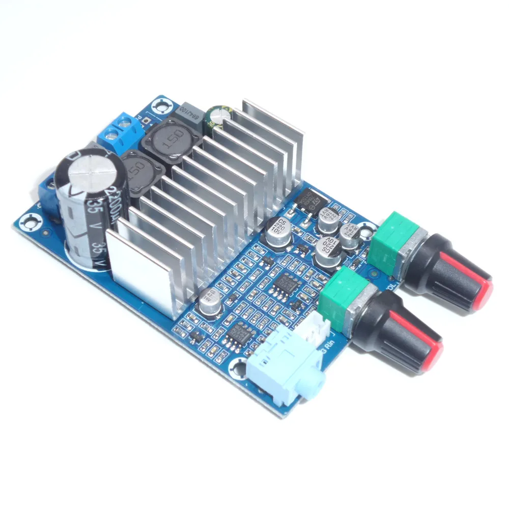

As most of you know the TPA3116 thread on AK has been a hot topic for over 3 years with thousands of happy owners. Now we have the mono subwoofer amp version with built in crossover.
I received mine today from China for the hefty sum of $12 and paired with a $11 24v psu I may get close to 75 watts into 4 ohms.
If this sub mono version performs like the standard TPA3116 I can expect very accurate bass and won't hesitate to use it to bi-amp the woofers on the bottom end of the Lowther open baffles.
Once I get it up and running Iook for my impressions on the TPA3116 and OB Epiphany threads.
