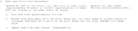

Did the dim bulb test and everything seems ok! Well except for a left channel with a weaker output (less volume and bass), so tried to check bias (saw some posts with instructions on checking mv across pin 13 and 15 on both channels) but I am confused;
- both channels seem to be wired differently on pin 13 and 15
- checked really different measurements
- now I'm doubting I got the proper test pin 13 and 15 points
Can anyone help me confirming pin 13 and 15?

In your photo, on the driver board rear connectors, pin 11 is on the left. They don't spec bias this way for the MC2205, the pots should be turned full CCW, then each channel turned CW until the input current runs up 50mA/5W from the baseline.
For a low channel / flatness problem I would suspect you need to look at dirty controls/connectors/switches/relay contacts or capacitors in the signal path. I don't think bias is your issue.
If you're running the amp on 220V, then the idle current should be 1/2 - or 25 mA. You need an AC current meter to monitor the input current draw of the amp from the 220V (or 120V) supply. There is no other way to set the bias properly.
As Bob said it's highly unlikely that the problem is bias. Clean the three switches in the back - one is for .75V/2.5V input, one is powerguard on/off, the last is mono/stereo. I've gone through three of these amps recently and all three had dirty switches. Best way to do this is to unplug it, turn the amp upside down, remove the bottom cover, and shoot a little Deoxit or other contact cleaner into the open portion of the switches, then exercise them well.

On the pin measurement methodology, just want to clear out the source; https://www.audioaficionado.org/showthread.php?t=3648
Do you guys have tried that method?
If do you think that method is OK, im having difficulties finding those pins. Is this image right? Trying to grasp it.

Your picture is not the driver board. You have a picture of the bottom of the connectors that hold the power supply/PG driver board and the meter driver board. The driver/output boards are right out in the open, if the amp is turned upside down. The bias adjust is the blue pot on each board. I presume that where the poster in that thread monitors the voltage is on the driver board.
All that said, unless you have proof that the bias is wrong DO NOT MESS WITH IT. There's another thread here where someone did exactly that with a MAC 4300V and his meter leads slipped as he did so, and it fried the driver and outputs. If you insist on doing so, follow the directions in the service manual:
If the heatsinks on one channel are heating up more than the other channel, with the amp at idle (no signal for ~15-30 minutes) then perhaps a look at the bias is in order. In my experience adjusting the bias does not make a huge difference in distortion - going from perhaps .015% down to .008% throughout the adjustment range of the pot at about 100W output where I tested this.
