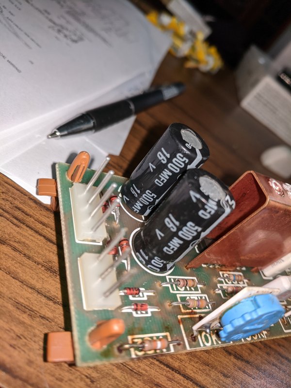

Hi Doug and all, I am not sure if you are still on this chat ... I followed bulletin #8 faithfully but the voltage between pin 4 & 6 can only go from 6.18 - 6.3 volt. And it's 0.01 volt between pin 5 & 7. Pin 4&5 tied together as ground, I think ... since my motor has a red and black leads, I should get something around 4 volts. Does that mean my circuit board is a goner?
I am thinking of replacing the caps 500uF/16v next. Should I start looking for the IC?
I spent 3 hours to clean and relube, get it to run about 30 minutes then the motor stuck. With power off, I can turn the motor easily but when I power one, look like the circuit has a magnetic field that lock the motor. I think somehow the circuit stuck in a phase the lock down the motor.
the light can be changed and dim but never flickering ...
Please help. My BIC 980 is almost new!!!
Thank you,
Well, it sounds like the board is bad but unplug the motor and try to adjust the voltages. If still bad, it's the board. Do the pots seem OK? Not rough or anything?

Pots look good and turning smoothly. My electrolytics caps are 500uF however... Thanks. I will try again without the motor connection... and will report back. The IC code is M642 377

Hi Doug,
I unplugged the motor, the voltage now is between 10.8 - 11.3 volts.
Will replace the caps next, then call upon Adam ...
Thanks,

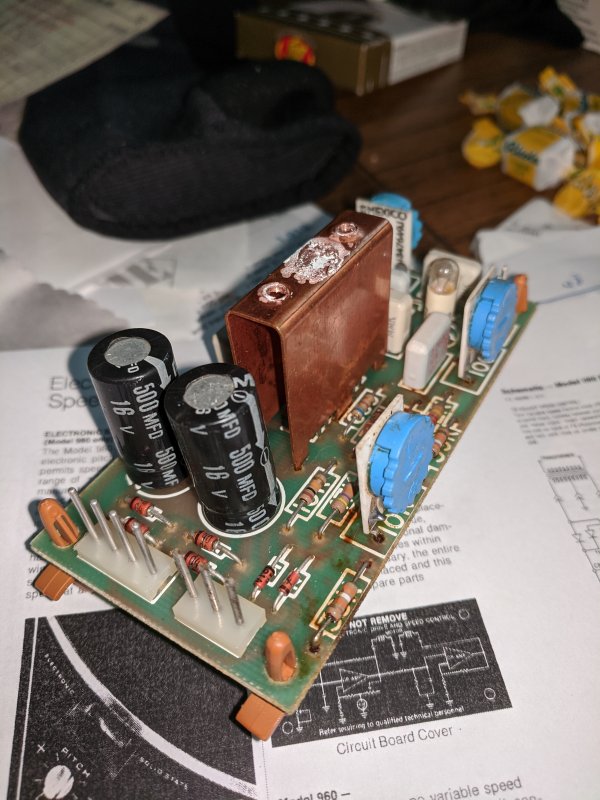

I replaced the caps. The old one labeled as 500uF measured at 670 uF. I replaced both with 460uF/50volts. The voltages between pin 4 & 6 does not change, still around 10.8 volts without motor connection. When connected they are at about 5.7 volts but the specs calls for 4 volts.
Also, it looks like the feedback loop is not working. I can only dim the bulb using the pot next to it, the one on the 2 power pins does not change the brightness of the bulb at all. Am I right that the feedback loop does not work? The light is always solid, only the brightness changed when I turn the pot next to it ...
I guess I now have to call Adam... Hope fully it's the IC. code is 377. Are you familiar with it?
Thanks,
The 10 volts with the circuit open is probably normal as the motor coils, which are actually part of the circuit, are not in circuit then. The pot right by the bulb, of course, is to adjust the two voltages to the motor coils. I guess I have never really noticed what turning it does with the bulb. The other pot on the long side of the board (down by the connectors) should make the bulb pulse AND make its brightness change.
The bulb always being at a steady brightness indicates one of the oscillators isn't working and, if all other parts, traces, etc. are good, the IC is the prime suspect as that IS the two oscillators (with the external components) to run the motor. Although I have never had a bad IC nor had to replace one, if everything else is OK, it must be that.
The 377 is a dual amplifier chip made into Wien bridge oscillators with external components. The resulting AC voltages power the motor coils and thus, cause it to run. The board adjustments are to get the outputs to the correct voltage for the motor and get the two oscillators in phase. The third pot, on the narrow end of the board, is just a rough adjustment for the motor to run at the correct speed when the control on top is set to its center position.
Doug
Doug, thank you for your kindness and clear explanation of the circuits and its function. My guess is that since the bulb is not flickering. It indicates that the IC/Oscillators are not working. But again, IC rarely fails. After replacing the caps, the voltage seems to go down somewhat but not at the specs they have specified in the Bulletin #8 (mine is a red/black cables to the motor). Have you seen the 2 caps valued at 500uF? someone else mentioned that those are 1000uF. Would that double the voltage in my circuit? to my knowledge, caps is to hold the amps, not volts ... !!! I really want to get this BIC980 to work since I already have problems with my Duals :-) ... BIC seems to be mechanically simpler but now I face this state of the art brushless motor issue :-) Again, thanks for your help. I am waiting for an email from Adam ...
The capacitor values aren't that critical. They just filter the DC supply voltage and your original were probably fine.
The problem IS with the oscillators and any one component in either oscillator being bad will stop the oscillation and thus, the motor. Of course, you want to be sure all the components and the board, itself, are OK but if they are, trying another LN377 is the next logical step. Although ICs are normally very reliable, it's possible it got overheated and failed.
