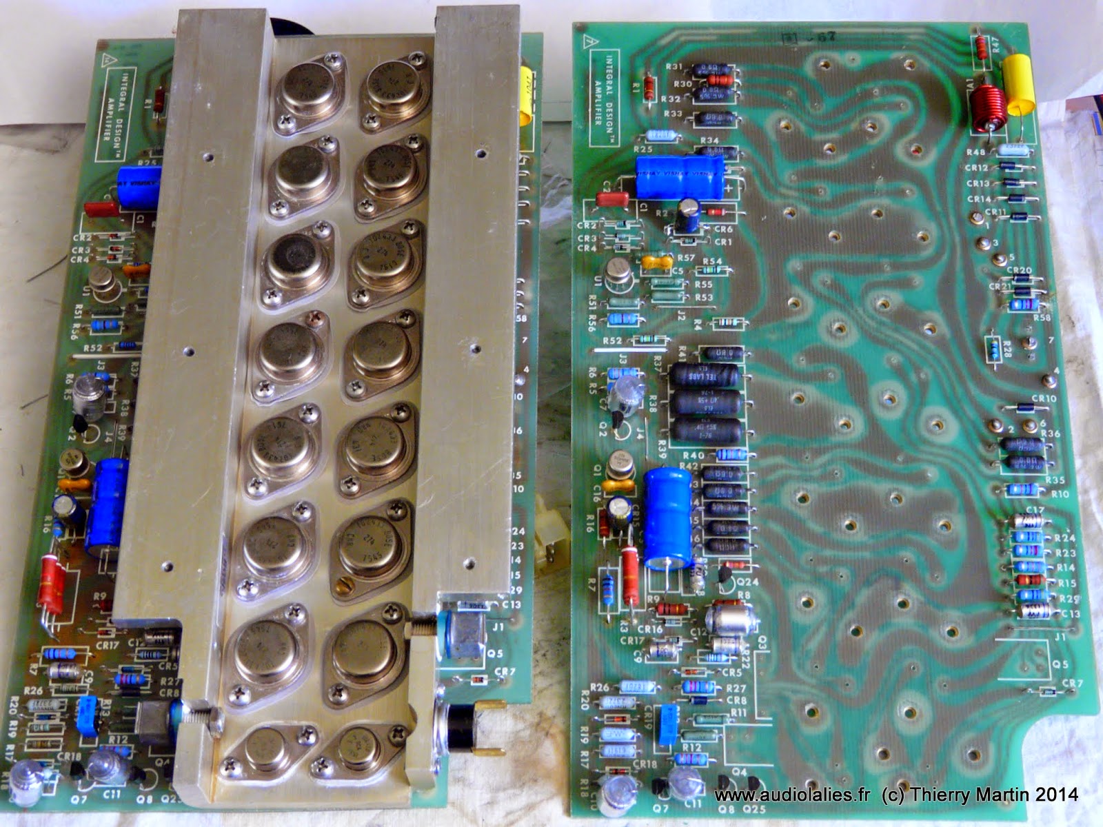

There are still a lot of items on my To Do list, one of them is to replace the input jack sockets. The original ones are so badly corroded that they'll never return to service.
One may ask why oh why don't you install RCA phono sockets instead of those outdated 1/4" telephone jacks ?
Reason is simple : as you may know the 1800 can be operated either in the classic 2 channel configuration (stereo) or as a 1 kilowatt / 8 ohms mono amplifier (and believe me, then that baby rocks).
This is achieved by inverting the input signal phase on channel 2 using a 1/4" stereo input socket and connecting speaker wire between both positive output - blue and red - terminals of the 1800.
Of course this cannot be done when using an RCA socket which by definition has only 2 contact points. That's the reason why I stick to the good old telephone jacks.

The story goes on with some cosmetic details. Restoration process goes slowly but I will not surrender !
One speaker terminal washer was broken, repaired it...
Scratched lettering on the back panel, fixed this too
As mentionned, the input jack sockets had rotten away :
Devil hides into details !
Issue solved.
One socket is mono and the other is stereo, wiring them needs some attention because of the phase inverting configuration for mono operation.
I made some paint marks to help remembering where goes each wire :D

I have started reassembly :
- heatsinks
- new capacitors
- new capacitors clamps
- cleaned and checked wiring harness
- new rectifier bridge
- new soft-start resistor.
It begins to look like a real 1800 rather than a wreck :yes:
Refurbished front panel is awaiting for refitting...
Some mechanical reassembly with the front panel being refitted with renovated screws. All parts are original, I had a tough work bringing them back to "almost looking as new" condition: each screw was thorouglhy brushed to remove the crust and then received a rust converter coat, then left alone for drying for a week.
With top cover on.
