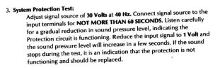

601 III has a built in protection circuit that lowers volume output when excessive power input could otherwise damage the tweeters. The circuit consists of a lamp connected in parallel with a thermal resistor (RT-1 & K-1) seen in the schematic below.
If you have the equipment, the circuit can be tested for correct function according to the service manual procedure:
As to crossover capacitors, there is only C1 as shown in the schematic above. If it's a film capacitor then it's unlikely to have degraded over time. If it's a non-polar electrolytic you might consider replacing it with either a fresh electrolytic or a film cap. The capacitance value of the cap could be one of three possible, as it has varied over production life of 601 III:
Replace with whatever value is found installed in your speakers. Though a failing capacitor probably wouldn't cause the symptoms you're experiencing.
