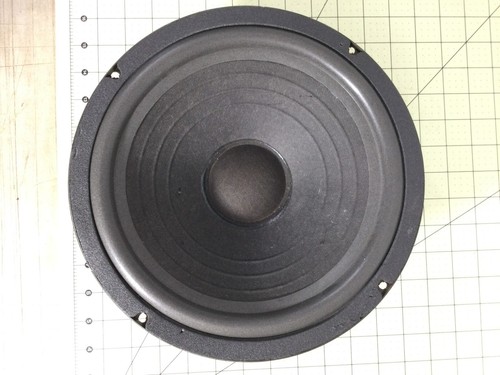

The A25GU30-51F woofer with the black-painted magnet and six spokes is NOT a Boston Acoustics woofer.
According to this older AK thread, the A25GU30-51F woofer is a Pioneer woofer, sometimes re-branded as "GOLDSOUND" and unfortunately doesn't match the sound of the original BA woofers:
On the other hand, your silver magnet woofer with the center vent hole and four spokes looks like a genuine Boston Acoustics woofer.
If you want to hear how the speakers originally sounded, you should look for another OEM BA four-spoked silver magnet woofer, and it would be best if you could make sure that both of your woofers are eventually re-foamed with proper original filleted profile foam surrounds.
Boston Acoustic 10" woofers from A150 and A100 speakers occasionally show up on ebay.
In fact, right now there is a refurbished OEM woofer from a pair of A100's on ebay that would be a much closer match, but it has an older style square magnet with no vent hole (BA switched from square to round, vented magnets in the early 1980's) Also, the foam surround is the wrong profile (it is not filleted)
Despite the differences, it would probably sound indistinguishable from your other BA woofer:
Refurbished Boston Acoustics A 100 10" Woofer
AudioKarma member, Ricky Cobb (ebay ID: looneytune2001) has been selling proper filleted Boston surrounds for decades on ebay, although I have also had good luck finding BA filleted surrounds from Simply Speaker and Midwest Sound as well.
