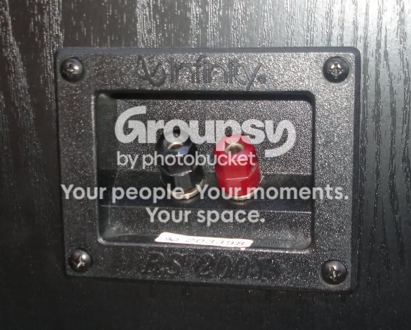

Look carefully on the terminal plate:
I have a set of Infinitys exactly as you describe.. Polycell (foam)Tweeter with 8" Poly Woofer. Mine are model "Reference Two" (Those have a round plate with the words "Reference Two" arc'd over the top. (Near impossible to see.. I had to put on my glasses)
Thanks for the info. Nope, I didn't have my glasses on either, so that may be why I didn't see the model on the terminal. Mine has a round block too. It does have the paper tag on it like the one in the picture, but nothing on it looked like a model.

It took me a while to realize that the Infinity model number is on the plastic terminal plug thingie. I actually did see it, but I didn't think they'd have made a different model of the plastic for each different speaker model!
I have SS-2001's I recently refoamed, pic in that big "Infinity pics" thread - other than the expected lack of bass in such a small speaker, I really like the sound.
Just checked, and it was written in the cup. They are SM-102
