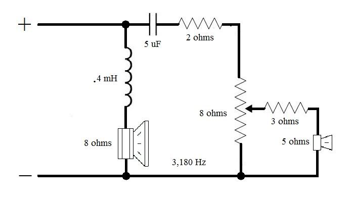

For the crossover I just did what sounds best to my ears.

How would that affect the crossover frequency? Also would a 5 uF capacitor work? If so I have one I can try now. I also have a 3.9 uF cap I can try.

EDIT: I found a Dayton 12 db/octave 2,500 Hz crossover and that seems to have helped, although I am not exactly sure why. I had intended for the Rola speaker to play much higher since it has a whizzer cone, but it seems like the 2,500 Hz crossover does integrate the woofer and tweeter better. Another option would be to build a smaller speaker cabinet and install a fairly efficient 12" or 15" woofer and build a 12 db/octave 150 Hz crossover. or I could even use a two way active crossover and integrate a powered sub. That is not the way I really want to go, but if it will be best I'm not opposed to it.
Hey Tube.
Yea, a 5uf would be fine. It's about the same x-over point, but maybe the sharper dropp-off would tame the peak. The 3.9uf would raise it too much, and there would be a hole in the mids. Do you have any way to measure the VC inductance or the fs of the driver? That would help alot.

So your meter doesn't do inductance. Too bad.
Thinking about this last night, maybe it's box induced resonance. That's a big box with no bracing anywhere. I might try a brace width-wise, in the middle of the side panels, just above the woofer. A 2x4 should do it.
