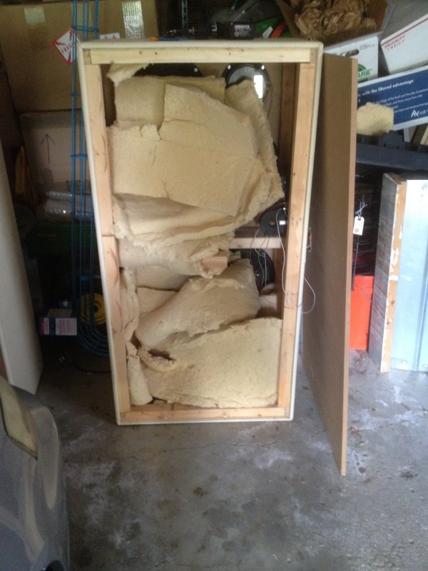

I'll load pictures after I snap a few but I suspect the existing cabinets while maybe decent aren't taking advantage of the hardware inside. The cabinets are recently and admidditly home brew by the very cool gentlemen I bought them from, they measure 48" x 24" W x 17" D. I know that because they barely fit laying down flat next to each other in the bed of a 2016 Chevy Silverado pick-up!

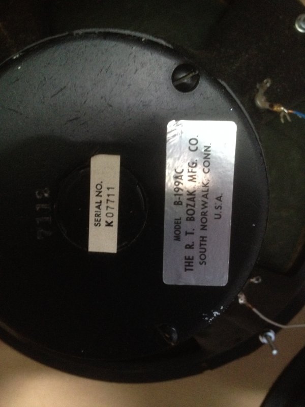

I opened one cabinets and wrote down the driver info and can share that the hardware includes the following:
Four, B-199AC woofers, sequential series numbers K07723 - 26, with an inked on code below of 7112;

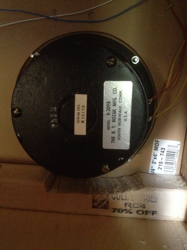

Two B 209-B mids, didn't write down any date code, need to double check those;
And Eight tweeters, four 200YC and four 200Y;

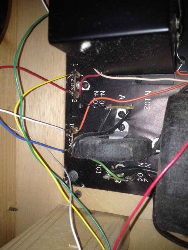

And the big old crossover network with that big ol' iron core inductor, not sure where to find the identifier on the XO, there are so many numbers on there...

Well, dang fire! It looks as though you got the good stuff in regards to the drivers! But the cabinets are far too small, they should be approximately 36" wide, 18" deep and 50" high.

All of the drivers are inked/stamped in faded white on the magnet face: 7112, is that a December 1971 manufacturing date?
The second cabinet contains:
Four: B-199AC, with identifier info as: K07711, 12, 13, & 15 (found the identifying 8 ohm plate on these);
Two: B-209B marked with K06145 & 59 (16 ohm); and
Eight tweeters: four 200Y & four 200YC (8 ohm)
Found the label on the XO, it's a N102

YUP !!! Dang. Okay, go on the net and do an image search for Bozak Concert Grand. You can see immediately the driver layout difference between yours and the factory cabinets. These drivers are all over the darned place. Getting these to image properly will be impossible, no matter how large your living room is. You must have at least 10 cubic feet of internal volume for the 4 B199 woofers to work properly. Also, the internal batting is just stuffed into the cabinet like a racoon did it, not cool.
Save the internal batting, that's gold right there pally boy. The sides, top and bottom get it loosely attached. And then the curtain must be installed. You can get an idea as to how this looks by checking google images.
You've got a real collection of the best Bozak drivers for Concert Grands there is, factory cotton batting, and you have the proper crossovers. All you need are proper cabinets and you're done. That may seem like a lot, and it is a fair amount of work. But the fact you have everything else is really huge.
