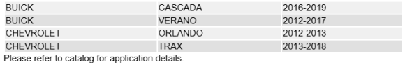

I know you said there is scant to none for info on this car, but, are the same brakes used on a different car that may have better documentation?
quick Rockauto search shows this for the rear caliper, no idea if the Cascada has better docs
Centric brand has this for cross-reference
