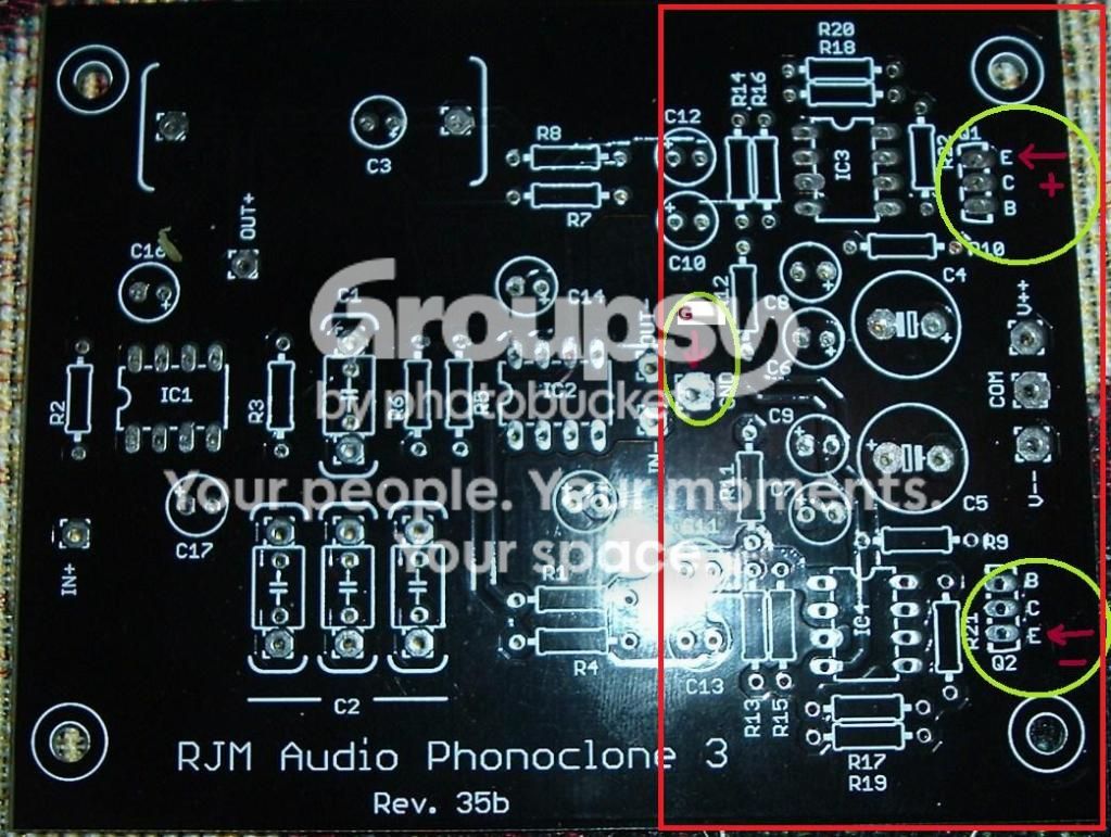

Step 3. Connect your batteries together like this:
WARNING: Use a connector that can't be reversed for the batteries as well as a double pole switch that disconnects both the negative and positive leads at the same time or permanent damage can be done to the op amps and/or your MC cart.
Either a XLR connector or something like this:
Then connect them to a switch which MUST be a double pole which disconnects both the negative and positive voltage at the same time, and a LED then the outputs to the points I have marked on the PCB's. You have your +, Gnd, - inputs. Each PCB is one channel so you will have to run the wires to each board.
Leave out the components in the red box as they are the x-reg components and not needed if you are using batteries.
Later on if you wish to install the x-reg components and run it from the mains using a separate transformer and bridge rectifiers you can do so, but always get an electrician to wire it up if you are unsure of working with mains voltages.
As for Op Amps, OPA27GP's are good in the input stages and AD797's turn it into a killer unit in the output stages. Thanks to Jim Reeves experimenting.
Get a nice case, LED, switch, RCA connectors and wires and your done.
