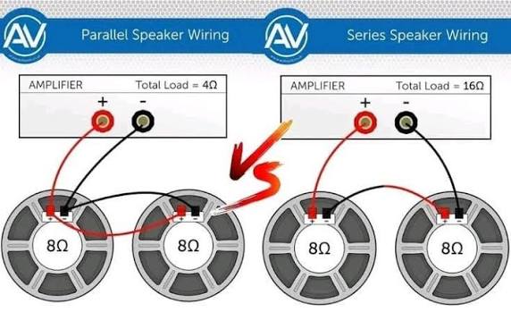

If you want to know what woofer you can connect, just make sure it matches in terms of nominal impedance (load in ohm)
Understanding dual woofer wiring:
Take parallel versus series wiring and how it affects speaker load (in ohms) into account.
Then verify at which nominal ohm load the original speaker was rated (the crossover terminals for the individual speakers has the same nominal ohm load).
Connecting speakers with a different nominal load than the intended load is not recommended to a crossocer without modifying the crossover as it will shift the crossover point up or down and lead to problems.
