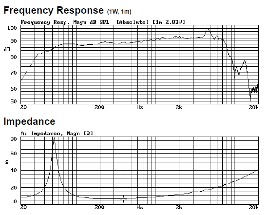

I have some AURA NS6-255-8A drivers that I want to use for a center channel on my 5.1 surround system. See link below.
The AURA's
https://www.parts-express.com/aura-ns6-255-8a-6-paper-cone-neodymium-magnet-woofer--299-030
I'm looking for advice on tweeter selection, crossover frequency, and cabinet design. I am only using a Yamaha receiver for power and I want to stay with 8ohms for the system.
I was thinking using (4) 8ohm AURA's in a series/parallel combination.
DESIGN OPTIONS: For the highs, I can do (2) 4ohm tweeters MTMMTM, TMMMMT; or (1) 8ohm tweeter MMTMM. I don't have much to spend on these; maybe $10-$20ea. Average listening distance is about 8' from the source so I thought having (2) tweeters a couple feet apart could help with dispersion.

CROSSOVER FREQUENCY: 3500Khz?
CABINET DESIGN: I have had great performance with the AURA's in a ported enclosure, but I thought an acoustic suspension design might be better here, not sure why. Any ideas for internal volume will be appreciated.
I've started doing this stuff in 2017, still learning, so just thoughts here no expertise. First thing I see when looking at the spec sheet for the Aura is a sharp response peak around 4500 hz (see pic). If you want to cut that peak out I think you'd want to either cross a bit lower than 3500 or use a higher-order crossover (3rd or higher). With the Dayton tweeter only going down to 2500, I guess you'd want to do the latter. Elsewhere in the DIY section I started a thread asking for crossover calc/layout tools, so if you need a calculator go check it out: http://www.audiokarma.org/forums/index.php?threads/software-tool-for-circuit-diagrams.776599/
As for the cabinet, there are sizing suggestions in the Q&A section on the PartsExpress page for that woofer.

CT_Ohio - I noticed that 4500hz peak on the Aura's. I was hoping a crossover point of 3500hz might help smooth it out. I wouldn't mind creating my own crossover, it just saves me a lot of time to buy an assembled one. Also, I really don't know much about crossover design yet. I did post a question on Parts Express about this too, thanks.

PE has plenty of premade crossovers, like this one at 3500hz (https://www.parts-express.com/dayton-audio-xo2w-35k-2-way-speaker-crossover-3500-hz--260-146) but most are designed for 8-ohms on the high side of the network. (The one I linked here is switchable on the low end via jumper.) A 6-driver array might require something more complicated, especially if you're mixing impedances, and hopefully the experienced guys here will comment on that.

Thanks, that is the crossover I plan on using. (4) 8ohm drivers can be wired in an 8ohm configuration; as well as (2) 4ohm drivers. Look up "SERIES" and "PARALLEL" wiring. I will hopefully have an 8 ohm impedance for both the highs and the lows.
