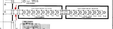

I have my SE-A70 recapped and had them install some LED kit from ebay. Good feedback etc from the seller, but I feel they're too bright and appear to be giving off more heat than I would think for LEDs. With that being said, can someone help me figure out what resistor I would need?
There is also two jumper wires in the middle of the two lamp circuit boards ( connecting the two boards ), Cant I put the resistor there, between the two boards? Or does it have to go on the positive or negative leads at the "start", coming off of the board?

I am going to take a guess so it won't be 100% accurate. I am assuming they replaced the lamps 1 for 1 so 16 LED's in parallel drawing (here is the guess) 10ma each would be 160ma total draw. That comes to what would be equivalent to a 75 ohm resistor. FYI 160ma at 12 volts is 1.2 watts so a bit of heat.
We are dealing with some form of at the very least half wave rectified (in the LED) pulsing/unfiltered AC so the values are not exact.
To drop the current flow in half we would need another 75 ohm resistor of at least 1 watts value. It should be dissipating close to 1/2 watt.
I would try a 100 ohm at one watts and see where that lands you. It has to be installed in one of the main leads not the jumper.
There are other variables at play here that would effect the numbers but I think this should be close if they used 16 LED's, if it is less the calculations will change.

I'd err on the side of caution, go with 20mA/LED draw say 300mA. Certainly part number or datasheet of the replacement would help. Maybe drop 1-2V say 6.8ohms? 1-2W rating?

Thanks guys, maybe if its too much heat coming from the resistor, Id rather just leave it as is then. Would the axial bulbs run hotter? Im guessing so since they're 55ma per and, like you guys stated, there is 16 total.

If the heat from a single resistor is too much, you can spread it across two. Instead of a single 6.8 ohm replacing one jumper, two 3.3 ohms, replacing each jumper would be near enough to the same.
Same total heat dissipation, just spread out more.

According to the schematic the original lamps are AC powered. We don't know if the tech who upgraded them used AC powered LEDs, or added a common rectifier.
It would be fairly simple to add a rectifier and small PWM module to the system but I don't know if @MOEB74 wants to or is able to go down that path.

Looks like they were internally commutated and controlled.
They were these from eBay. So plug and play essentially
OK that helps a bit. With three LED chips per lamp I can see where they are probably brighter.
Since they are 8 to 24 V, how well will a resistor work?
The ebay ad states 8-14 volts not 8-24 (typo?) It simply means that they will work in that range of voltages. Typically the higher the voltage the brighter they will be.
And yes a simple resistor should work fine. If you are considering adding one you can simply test a couple of values and see what works best.

Thtas what I was thinking but dont know where to start... They should be 2w or 1w? How do we, I, determine what value wattage to use?
Without knowing what current values we are working with I can't be exact. 1 Watt should be plenty safe for experimenting.
Once you find the value that works for you then measure the voltage drop across the resistor and use ohms law to calculate the power dissipation and see if you are in the safe zone.
