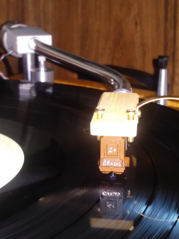

here's another model series with "odd" color body, and pewter coil cover example. Both are brown bodied Z2+ examples. Most of the Z series were black bodies, including the other two versions of the Z 1/Z2 carts. The flash kinda bleaches things out. the Z2 mounted in the AR headshell has a gold coil cover
My brown body / gold cover Z+ with amazing .2x.7 nude / titanium cant'r, retip by Joseph. Both of my M+ p-mounts have brown bodies / gold covers as well.

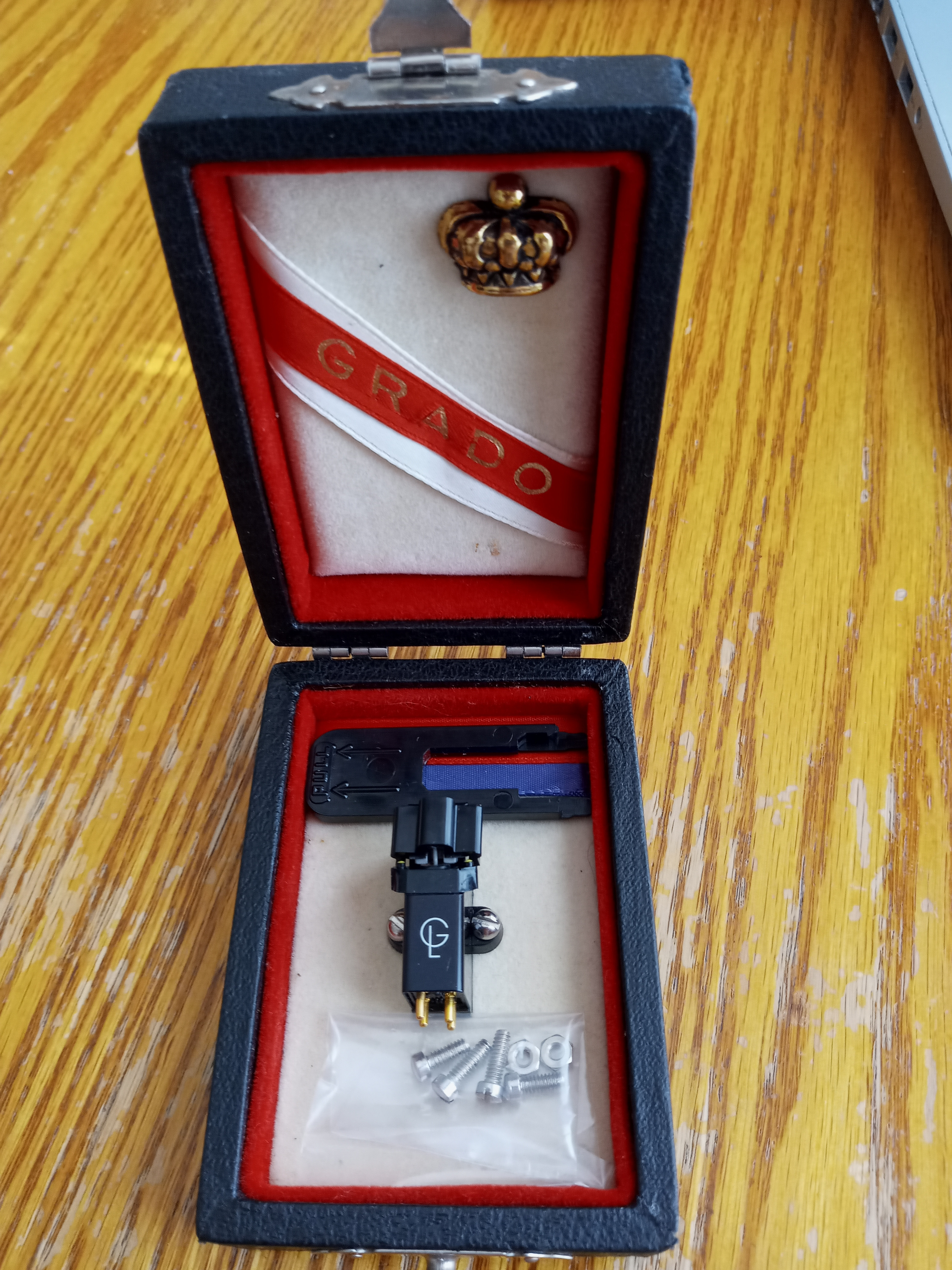

Here's my NOS black/black. January 1980. I had another black/black but one of the coils went bad. I took the ANOS stylus out of it and sent the body to Joseph to see if he could fix it. He couldn't. So I let him keep the body to use as a fixture for looking at Grado styli under his microscope. I have several brown/gold G1+ and G2+ here in the stash too. I'll have to dig those out for some photos.
