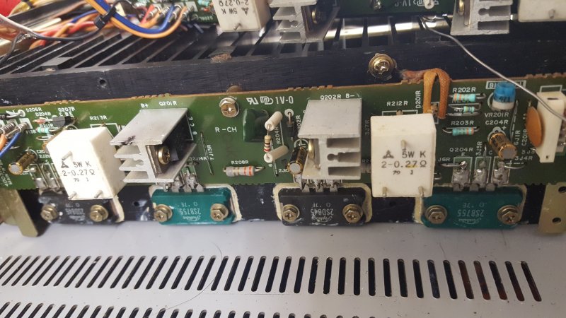

Hi all:
Full disclosure: I am no expert at this stuff. I have repaired my fair share of equipment but most of those repairs were straight forward, easy to find parts repairs. I am trying to learn at least one thing everyday.
I am working on a SAE A202. I cannot bias this thing at all. The device plays but at low volume there are some artifacts. The heat sinks remain cold. I started Googling information about biasing diodes and blhagstrom pointed me in the directions of some mind blowing information on how members of this forum were constructing bias diodes from common diodes in a string. I thought "cool this is where I should start".
The bias diodes in this amp are super fragile so I did not want to remove them unless absolutely necessary.
If I measure across them in circuit, with my Fluke in diode mode, I read @ 1.63 volts.
If I measure voltage drop across them while the amp is powered up I read @ 1.9 volts.
I was really ramped up about building my own "homegrown" bias diode but after taking these measurements I think my bias diodes may be ok.
If I put my DMM across the emitter resistors of the two adjacent output transistors I read absolute zero. Turning the pot makes no difference. I have no documentation for this amp. I have done rudimentary checks across the few components on each amp module. The resistors have drifted a little but nothing dramatic. Any ideas or clues?

Decided I wanted to take a photo of the amp module board layout for elnaldo, since I did not have schematics etc for this amp.
Looked at the variac's lighted switch. It was off....good ! Moved the amp module and sparks begin to fly as the emitter resistor of one channel touches the heat sink of a driver on the other channel.
Why did this happen? I forgot I was not plugged into the variac anymore. Two output transistors are gone. No tears, just moving on. I am not ashamed to say how stupid I am.
I pulled the 4 output transistors and am ready to move on working with the remaining channel. In some ways this is good. I consider it the cost of my continuous education.
In trying to help myself I find ways to hurt myself.
Now I am worried about sourcing authentic Toshiba 2SD845 and 2SB755. I really don't want to test the ebay waters with their flood of counterfeit crap. Any reliable sources are appreciated.
Here is a picture of my wonderful arc strike on the heat sink.>>>
Also @elnaldo this was the pic I wanted to send you to show the topology of the amp just before I went off on my arc adventure. The four outputs on the bottom and I believe two drivers above Sanken 958 and Sanken C2168. I believe anything to do with biasing is located on this board. There is a smaller input board hanging off to the side with a 5 wire umbilical attached to each channel. DC bias is done at the input board.

Hello. Please take it easy and relax, we can fix this small board if we are careful and proceed step by step. Worst scenario would be to replace ALL the components , what could be done in one afternoon, it's a small board.
Don't install the output transistors until the voltages are OK. Expect around 0.5V at the output transistors bases. It should react to the bias trimpot.
What I'd do:
To clean the pads where the output transistors should be. You need a solder wick to do that.
Then, clean with the wick every other soldering point you have made. You need to trust 100% there isn't any solder bridge shorting 2 traces, or any broken PCB trace. If needed use a magnifying glass.
Then, test the Driver transistors (you can do it in circuit), with the meter in diode mode, check they are not shorted. If in doubt, replace them both. A new transistor is cheaper than the time to test it. Check or confirm if they must be insulated from the heat-sink. Rail voltage at the bases indicates a short, or the driver, or other component and the alectricity find it's path to the driver's base. Check the emitter resistors are OK (resistors connected to driver's emitters)
check the bias diode. If it's a STV-3h or 4h, expect a couple of volt voltage drop, you can't measure it with a regular meter. You need a battery and a resistor in series with the diode, or just test it in circuit later, measuring the voltage drop across it.
Check the bias trimpot is OK, resistance across it, and resistance moving smoothly when you rotate the screw.
Connector labeled "A" is directly connected to your bias trimpot, check the components on the other board. To have bias current, you need a current flow through several transistors and resistors, you can confirm the current is flowing measuring voltages across the resistors. If some resistor is getting too hot, too much current there. The bias circuit handle low currents, so nothing should be too hot when the amp is idling.
Then, proceed to test the voltages, check for +V and -V at the collector tabs of the output transistors, aprox 0.5V at the bases, and near zero at the emitter tabs.

Your tests seem OK, drivers not shorted (always keep in mind that a semiconductor can pass a test with a meter under 3 Volts, but fail in circuit holding 50 or 60V), and bias diode not shorted or open.
If supply voltage is OK, I'd try the circuit without the output transistors again. Check every ground connection to the board is OK. If in doubt, assemble the unit and try everything in it's place.
Check the voltage drop at the diode when powered. Then, that diode should be connector to some transistors. test those too.

Is there any possibility that lines 4 and 2 are putting out those high numbers because the output transistors are not mounted? I guess what I am getting at is, even a low biased amp will still have some current flowing through the output transistors. Isn't this somehow fed back to biasing circuit to even things out? I just find it funny that the bias voltage wire near the +rail is inverted to negative. The bias line near the minus rail is inverted positive.
I am tempted to put the remaining two good of four transistors back on the board and see if they blow up .
What's the voltage at the drivers ?
What's the voltage at the output transistors connection tabs? That will tell you if the circuit is OK. Expect +V at the collector tabs, 0.5V at the base tab, 0V at the emitter tab. If you have high voltage at the base or emitter tab, there is still a problem, I'd fix or find out what's happening before installing the output transistors.
I see you are not sure about pins 2 & 4 function since you write a "?". Any open circuit with no current flow because one end is disconnected will show the supply voltage to the circuit when you measure.
Check the DC at the audio output pin, that's the junction of output emitter resistors. Check voltage at the drivers BCE and voltage drop at the driver's emitter resistor.
Build a DBT. it will save your parts if there is a short.
