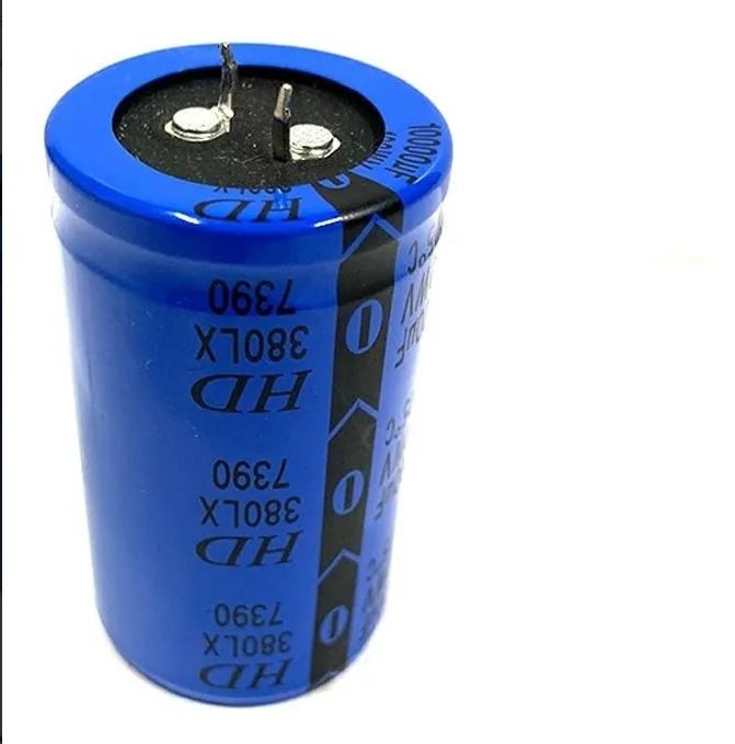

I´d like to replace the main capacitors for new ones. the 2385 have the pair of duals 6800uf/85v, i think to install 4*10000uf/100v is a good idea. I found cheaps caps here, but i can´t find the manufacturer, and i´m really worried about install good pieces for my little monster.
Does anyone recognize the brand or manufacturer?
Regards
Which would tell me they’re a copycat model and of unknown quality. That said I don’t know enough about fakes to be 100% sure.
