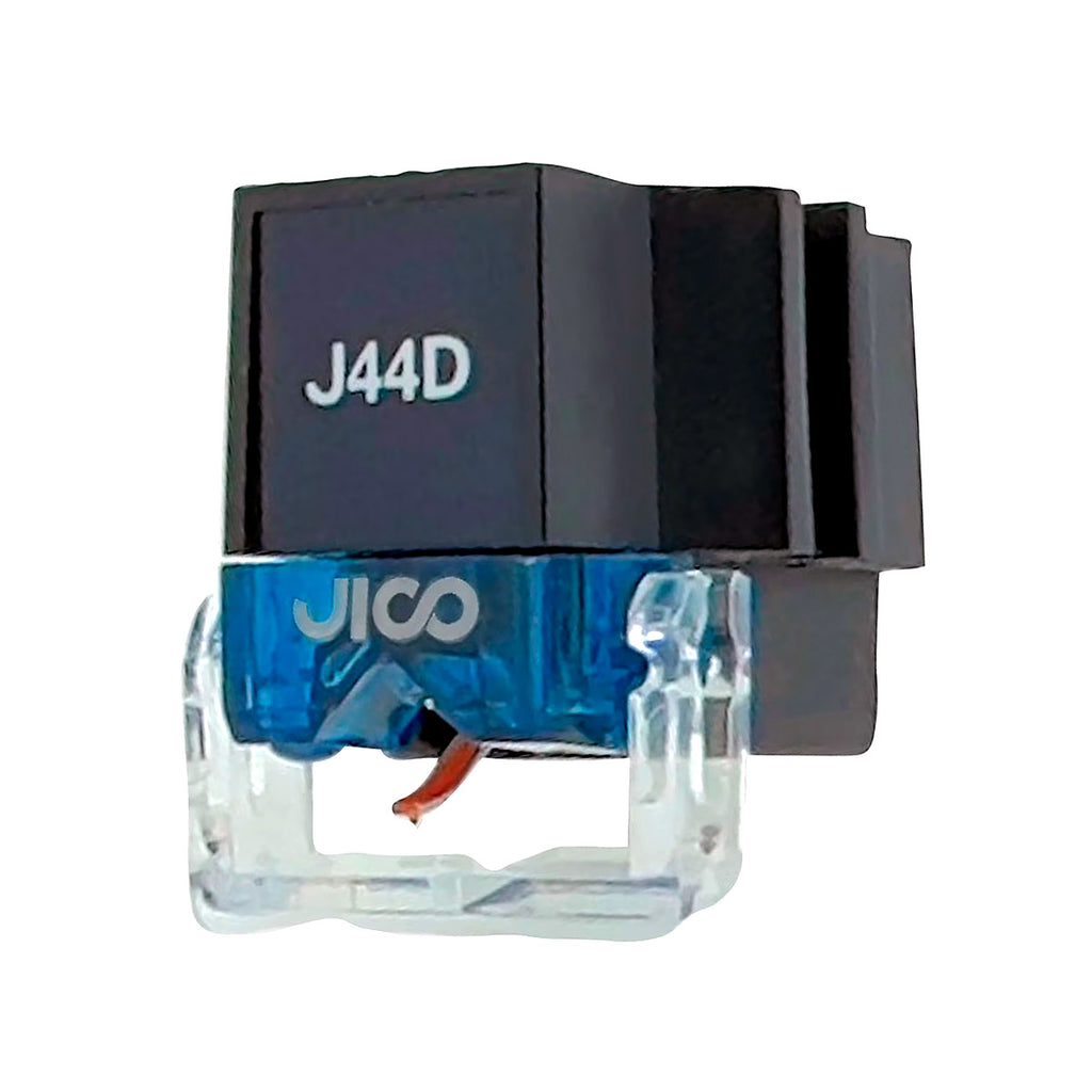

HI, this is my first post here.
I was given an SL-23 TT which I have finished refurbishing except for the Shure RTX-4 with a broken stylus. I would like to upgrade the cartridge to a more modern one but I dont know what type to get. I've seen seen recommendations that it should be fitted with a high tracking force cartridge. Should I limit my search to 3g+ cartridges (if there are any now) or can I consider 2g and under?
The 4 pin headshell has a single screw hole for mounting the cartridge and there's a threaded plastic block to adapt to the two screws on the Shure (0.5" separation"). Would I need a new headshell to accomodate a newer cartridge or just a new adapter? Would an AT headshell fit and connect to my tonearm? I'm prepared to spend up to $120 and would like to buy one good cartridge and be done. I am at that age where my hearing is not what it used to be but distortion still bothers me.

That's not true at all. I've used my SL-23 at least 100 times in the last year or two with cartridges tracking between 1.25 - 2.00 grams & have never encountered any issues. As far as a cartridge recommendation, stretch your budget a bit and buy an Audio Technics AT-VM95ML ($166 on Amazon). They sound quite good & are easy on records. You will have to buy a new slotted headshell (as little as $13) though since the AT-VM95 line of cartridges have threaded inserts & you wouldn't be able to get a firm mount going from the threaded inserts to the threaded block on that style Technics headshell.
Shure RXT-4 you mean I assume?
I'd consider a Jico SAS element for your RXT cartridge, as mentioned in this thread about it ;)

Thanks for the reply. Are all these headshells interchangeable with the tonearms? Standardization, what a concept. So I could get an AT HS6BK ($29) and that would work with this TT? The AT-VM95ML with a headshell is $200. A bit pricey for me but I could jump down a level or two with the same setup.

I would look for something that tracks around 1-1/2 to 2 grams (+-)
The threaded plastic block is part of the headshell, the single screw holding it allows the block with cartridge mounted, to be adjusted for proper overhang. Any 1/2" cartridge should work.
no, the stock 2-piece headshell is all you need
I think so but you can use the one you have
Yes, my bad. Thanks for that link. I will consider using the old cartridge. The stylus was sheared off so I don't know what condition the cartridge is in. I'm a little concerned about getting a new stylus just to find out the cartridge is bad.

Ah I see. If the body looks in good condition I wouldn't worry. If the body looks damaged; Time to look at another option.. Or get a cheap replacement cartridge to find out as 1st step. . Just a thought!

I don't have any specs on the RXT-4. What tracking force would I set?
I'm not sure you can go from one threaded body to another & get a secure mount. May work & may not....
If you are thinking about getting a stylus for the Shure RXT-4 you should know that original styli are extremely hard to come by and after-market styli are a crap-shoot in terms of quality, especially for that particular cartridge with the damping brush.
Another problem with the RXT-4 is the plastic housing, it is very brittle and if the mounting screws are torqued too much, the housing can crack
I suggest you look for a new, current production cartridge so that when you need another stylus (they don't last forever) you can find one easily.
Most of the time with MM cartridges, it is the stylus that costs so much, not the cartridge body itself. Sometimes you can even find a cartridge/stylus combo cheaper than the very same stylus, alone.
Well, there's a lot of ways to go wrong, it seems. The refurbish was easy compared to replacing the cartridge. All good information. I'll check back in after I get that sorted.
Thanks all.
I bought an Ortofon Red and a new headshell from Amazon for this turntable. My test record is Shadowfax's Too Far to Whisper on Windham Hill. It sounds great!!
