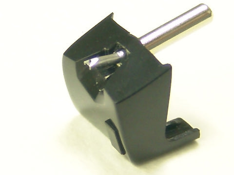

Cartridge identifying wanted to lake sure this takes stanton 500 stylus

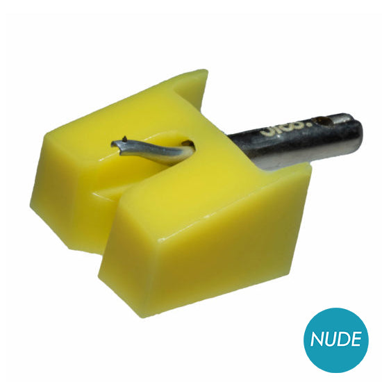

Seen a post of a very similar cartridge looking to image.jpgimage.jpgimage.jpgmine just wanted to make sure i bought the right stylus for this cartridge (i bought stanton 500 stylus)
Also if you could also explain what is recommended counterweight and anti skate dial amount for this particular one (i know i still need a stylus but to get the right amount if you can please lmk the right amount with stylus)

The linked website said that the stylus needs 3 to 7 grams. it is usually the stylus that determines the tracking force and not the body of the cartridge. Typically the tracking force and anti skate will match. For example, if you put the tracking force for this cartridge at 3 grams, then the anti skate would also be 3 grams. Hope this helps!
Tracking force depends on the stylus, the 3-7 gram is also a fairly hot output, and more suited for somewhat clunky record changers. Just from my own experience, I've found that the aftermarket ones for this type tend to be less than amazing, though its been a long time since I had a non-OEM 3-7 gram conical so possibly they have gotten better. Also mine was for a Pickering V15, which is the same cartridge internally but the plastic around the stylus looks a little different.
personal opinion, if you can get one that runs in the 2-5 or 1-3 gram range it would probably be a better match. That doesn't look like a clunky arm so it should handle the lighter weight with no fuss.

Knowing how to use a multimeter for basic measurements is a good idea, but the cart you have there is a 500, not a 680, no question about it.
