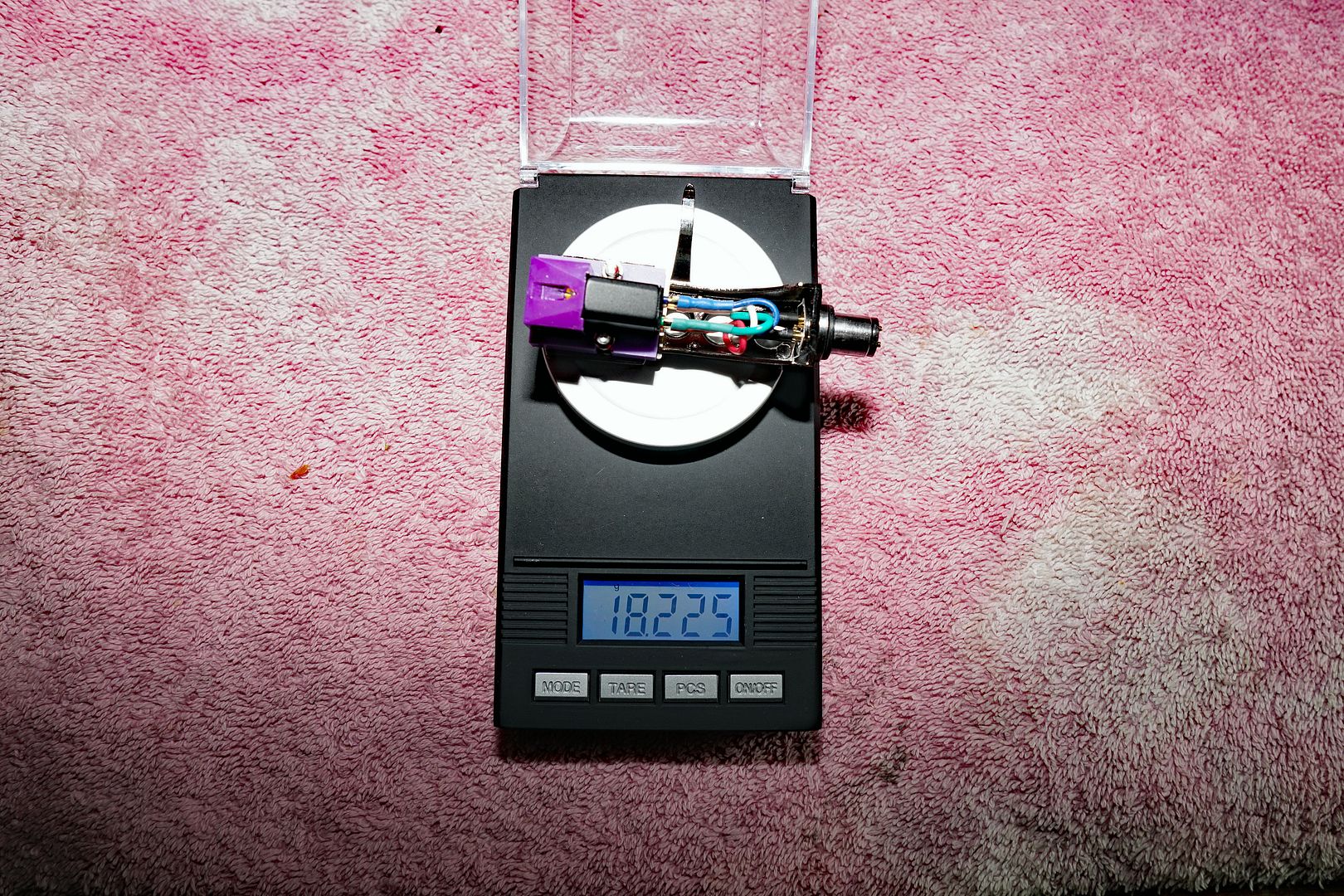

I went ahead and weighed my headshell just to help share data. Mine seems to be between 6.57 and 6.59 grams all told.

I’ve measured ‘em a couple grams higher but that was on a higher range scale. I’ll reweigh them on the tracking force scale for a better number. With wires and finger lift. Only arms don’t use the finger lift on is the Magnepans.
Have the upgraded SME "R" series headshell on my 3009 Improved arm. Doesn't have the two sets of three holes forward of the screw slots on each side. This headshell weighs a gram heavier.

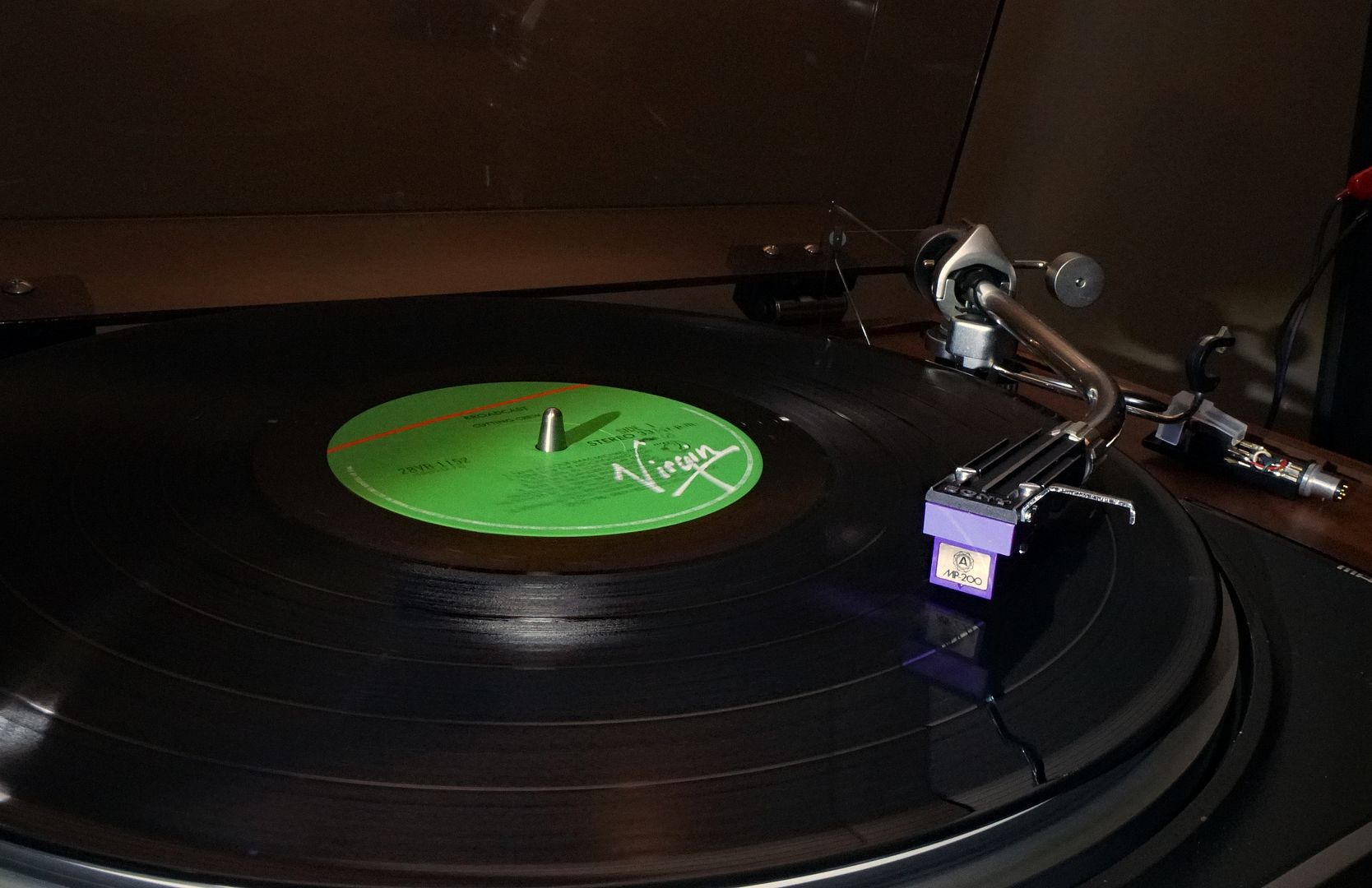

I liked the Nagaoka MP-200 on my 3009. Eventually, I went to MC cartridges.
