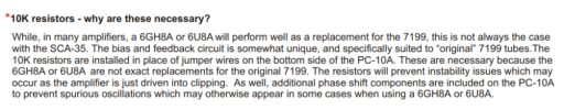

I believe this is why Dave Gillespie recommends adding 10K grid stoppers in his PC-10A boards for the Dynaco SCA-35.
This isn't likely to be a remedy for local oscillation at the 6U8 (or similar replacement).
My question though is why a 10K just for the inverted tube grid and not the non inverted?
Only Dave knows for sure, but my guess would be that he arrived at this through empirical testing. I would only question why such a large value of resistor is required, and whether this actually points to a different root cause.
