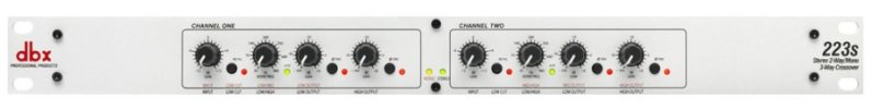

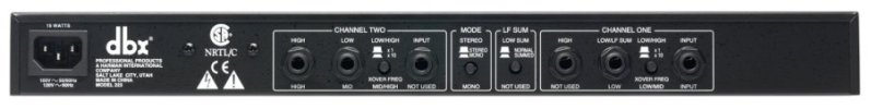

I used this one when I played in the band.... splits the signal to separate power amps, one for the tops, one for the subs.. An external crossover, adjustable, for level and crossover point
