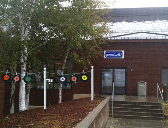

The SB treatment was real simple. I used the 4-1/2" dent pullers available at harbor freight ($2.99 each) to protect the label (2 - one on each side). This album had been spin cleaned before so I simply sprayed SB on and let it sit for a couple of minutes. I then rinsed with distilled water and dried it using those surgical sponge things that spin clean sells (those scare me btw).
I did the same with a half dozen records last night. I had bought them for ten cents each with mold and water damage/paper stuck in the grooves.
I used the "Scrubbles" first, then the spin clean however. They were titles I just wanted to hear. The least damaged was Weather Report's 2nd LP and it sounded great when I played it earlier tonight.
I only get the "Bubbles" out for special occasions such as this. It works in a couple of minutes then spray-rinse 'em off in the sink, a quick dry and Spin-Clean. I think dent pullers are particularly useful with the SB's - not good for labels...maybe not good for the vinyl, but now they are playable.
I can at least hear the music now, see what I like. The Fillmore East was a mess but it was the early purple label so I grabbed it. That one I already had in about every format available!
By the way, when using my Spin Clean I always start with the cleanest disks and work towards the grimy thrift store grabs. If the dirty ones peak my interest musically, I figure I can run them through the SC again later.
These are the records, BTW.
