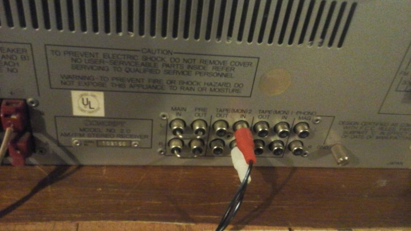

I picked up a concept 2.0 receiver for 20 bucks. Lights function and all looked good. However, both tape inputs, fm section and phono section only give very quiet audio that is very distorted. I even hooked up directly to the main in to see if it was a preamo issue Same results going straight into the power section. So I think I've narrowed it down to a power section isssue, I'm just unsure what to try next to repair it. Any help would be great!

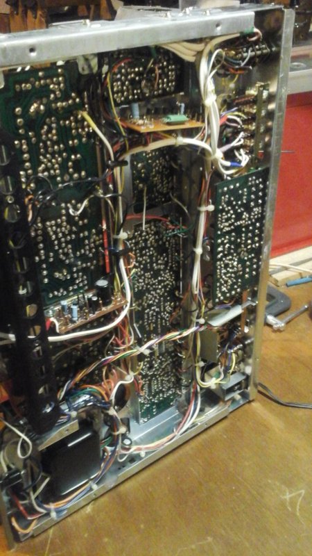

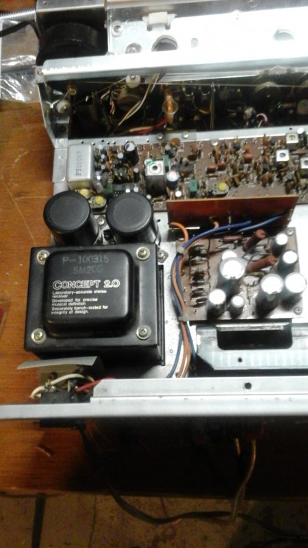

I did some more testing. I checked the transformer and that seems good. Right and left channel are both good all the way to the preamp out.
Channel A and Channel B give me sound out of the left channel. with the volume turned up, but it's very distorted/overdriven and a very low volume.

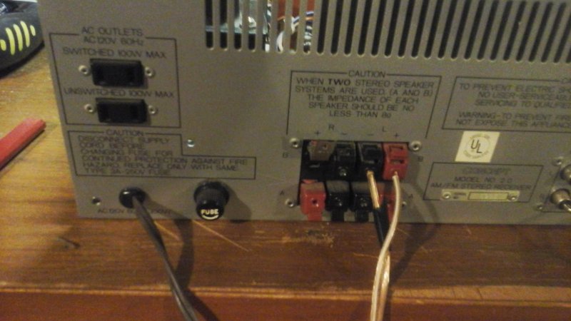

Channel A and Channel B give me a 60 cycle hum and no sound (music) when I attach the positive speaker wire.

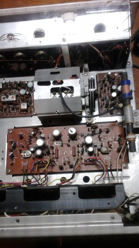

I found a schematic. I'm thinking something on the right channel is grounding out. I'm assuming that it must be occuring before the channel A and B split since both channels show the same symptoms.
It's almost as if full power is going to the right channel via a hum, but no music will come through.
