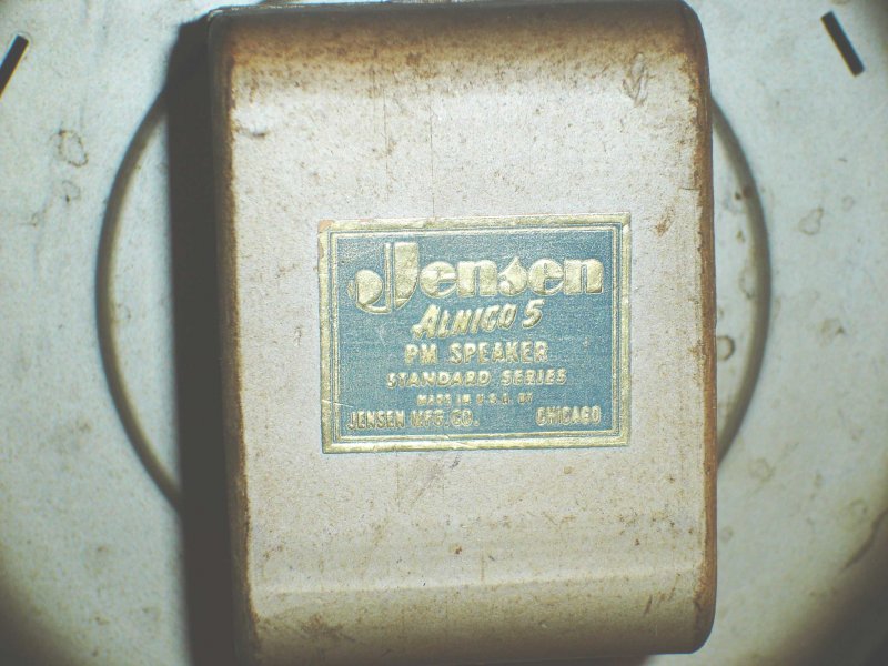

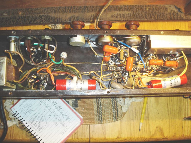

Hello everyone new member here. I have a 1949 Gibson GA30 with the OT mounted on the speaker basket. The amp is working. I just replaced some plate resistors and some coupling and tone capacitors.

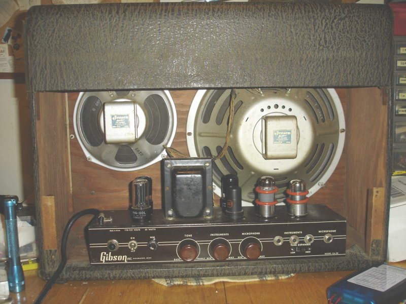

When I touched the speaker I became acutely aware that there is something painfully wrong. The speaker frame and the output transformer housing have 316 volts on them. It's the plate voltage for the 6V6 power tubes. As I said the output transformer is mounted to the speaker frame. It could be the B+ wire insulation is worn and shorting as it is clamped to the speaker basket 68 years ago.
My question is could it be the primary is shorting on its housing inside the transformer?
Has anyone heard or seen such? Could a transformer short is such a way?
Today I will pull the speakers and inspect the wires to the OT. Btw the secondary and feedback wires shows no such voltage.

I think you're right to suspect the wiring first. Disconnect the wiring, and check the resistance between the speaker frame and the transformer primary with a volt ohm meter. If it's shorted, cut or bend open the metal strap that holds the wires to the speaker frame, hold them well separate, and measure again. If it's now open, put some heat shrink on the old wires and put it all back together.
If it is indeed the transformer, seek out a replacement. I would probably just abandon the old transformer in place, and mount a replacement on the speaker board off to the side. Chances are the new one won't fit the speaker mounting holes exactly anyway, and even if it did I would worry about damaging the speaker while grinding the riviets off. May be time to upgrade to a new production Jensen speaker.. those sound quite nice!

Lots of old radios, record players, televisions, etc. had the output transformer mounted on the speaker, it was more or less common practice at the time that amp was made. The practice was carried through to today, for public address speakers, which are still available with a transformer mounted on the speaker.
It is functionally and electrically no different from having the transformer mounted on the amplifier, or anywhere else for that matter.

Here's some pix guys.I measured resistance from the power tube plates to the output transformer and came up with about 600 ohms. Which probably means that the transformer is shorting.
Vez - Yes, it can certainly be shorted to the frame from the primary side (only). The secondary (and feedback line) could still be isolated. With 6V6's, the load resistance (primary) should be about 8000 Ohms, so your 600 would indicate a short near one end of the pri. coil. An 8K Ohm, 15w. transformer should fix the problem.
