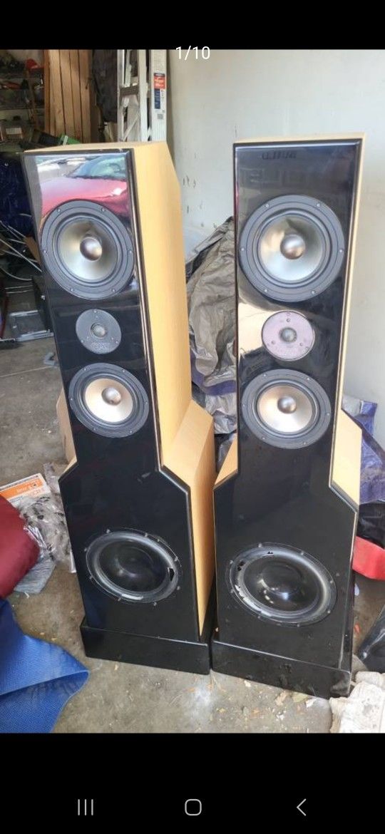

Hi Folks,
Bit of a mystery here. Friend bought a pair of speakers that we're advertised as "custom Canton" speakers. But, they don't seem to have any Canton components. The tweeters and the mids appear to be California Audio Technology units and the woofers have "Hales" stickers on them.
So, the question is does anyone recognize these or are they really custom speakers?
Thanks!
Jeff

They sure look to be custom (aka DIY) speakers. The drivers were apparently pilfered from commercial speakers, which is not unusual. And California Audio Technologies and Hales did not make their own woofers and tweeters.. They were probably made to spec by companies like SEAS or Vifa. They could sound pretty good IF they have a properly designed crossover. Otherwise, who knows?
I kind of thought the same thing, but CAT’s own speaker have a similarly shaped cabinet…these go for $500k.
Flattering attempt at a clone.
Genuine CAT's have an impressive high gloss finish(like freekin' glass) on all surfaces, all corners are rounded with a small radius, and unlike the speaker in the OP, CAT cut the same size radius for the corners of the crossover/input panel, and the opening it goes in.

That's an acceptable hypothesis. Although, if you look at the last photo posted, the crossover board near the woofer says "California Audio Technology".
Perhaps of more pressing concern, both woofers need new rubber surrounds. These are serious woofers and the only clue to their origin is a sticker on each magnet that says, "Hales 100805-A05". It's a 10" unit with a .75" roll.

Well, now that I've seen that the crossover boards and mids/tweeters are all CAT products, I wonder if this is an early prototype without all of the fine craftsmanship. I guess the next question is: Did CAT make their crossover boards and/or drivers available to the public at any time?
I'll also tell you that the new owner thinks that they sound very good and he has many excellent speakers currently (Focal, Wilson, Tekton, Sonus Faber).

It's possible, but I don't remember seeing them being offered. Similarly, I don't recall any Hales woofers being seen in the DIY community. Doesn't mean it didn't happen, but I would think that someone here would have heard if they did.
I seem to recall something about Hales liquidating their inventory when they folded up, so that may be how the builder acquired the Hales woofers.
My buddy reached out to Madisound and here's the reply he got:
Thanks for sending the pictures.
Although we won't be able to supply you a surround, there is an interesting story here and that info may help you out.
My co-worker Brian somehow remembered being shopped these woofers back in 2001 and has a letter from Paul Hales w/ info on them! Looks like we passed and CAT bought them.
They are Focal woofers. The part number is 10L6411 which is similar to a 10K6411.
Maybe you can find a Focal surround or someone that knows about them. Try guys off this list if you haven't already:
https://www.madisoundspeakerstore.com/speaker-repair
My buddy finally got to talk to someone from CAT. Apparently these were custom built by CAT for a dealer back in the early 2000s. It is designed to be driven by 4 channels of amplification (1 channel to the bass and 1 to the mids/tweeter per side) with an external crossover. CAT didn't have a purpose-built crossover, nor did they specify a crossover point or slope, which I found a bit odd. The guidance was to experiment in the neighborhood of 100 Hz. So, right now he's playing with a miniDSP.
I will say that it sounded quite good when I heard it on Saturday, though I think the bass needs to be dialed in a bit more.
