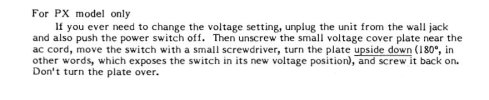

It is behind a cover on the back panel. You can see it right behind the transformer.
Btw, I had previously just used continuity to test the switch and it beeped when on and did not when off. Make sense?
I think, correct me if I'm wrong, when briefly reading through the manual that back wiring has a voltage block that you turn over and rewire to change the voltage for the unit, I don't think it's a switch. Do you agree or am I just missing the switch?
Yep continuity is what we are looking for in a switch. Sometimes a transformer can have enough resistance that the continuity beeper is not triggered even if the transformer is good.
It looks like there is actually a switch behind the plate on the PX model only. It is a real longshot that is the problem.
