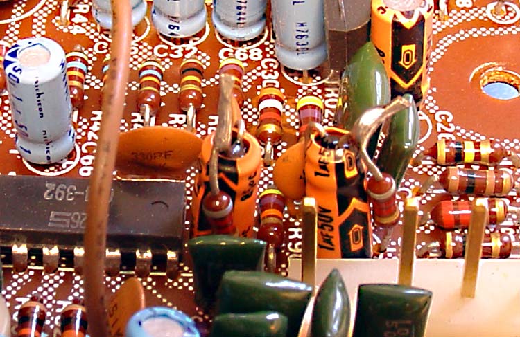

3AE5FE68-6880-4F97-81FA-4FA7BBA6D6A1.jpegHey everyone, during my recap I’ve run into the usual values differing from the SM, but this one has me BAFFLED :no:. This is the F-2505 flat amp board. Pics show it; caps c09 & c10, both leads are soldered together? These are polarized 47uf 6.3v
This amp ran very well for years before I ever opened it.
How can this be? Any help greatly appreciated. J. DB9ED77C-0C86-4F6A-92B1-A689A25985AC.jpeg 821AE00D-85C1-4718-86D8-540BD0D7B7D9.jpeg

need to look at schematic ..it may be a run of board errors early production and that was the fix .. just a guess ..
This serial Puts it in 1975 span. I’ve got large ground planes separated via dremel,?then a jumper connecting same ground. When I finish this beast I’lol post the photo history from beginning, thanks- will take a look @ schematic for sure.
my suspicions are maybe wrong but both channels being the same is hard to believe a mistake in soldering has taken place .
best i can say is leave it as it is seeing as it works .maybe someone can it through spice to see the difference .
Shortage of bipolar caps when the beast was built?
One of my favorite factory official kludge jobs ... Not enough room to add a dropping resistor to tweak the voltage, so they just put the caps in upside down and soldered the resistor to one of the cap legs ...
True. With R19/C09 and R20/C10 being a parallel RC network on the emitters of TR07/TR08. Maybe it was doing the wrong phase shifting? Wrong impedance? Oscillations?

Nope! There's no equalization going on with the capacitors leads soldered together and the resistors become redundant, as the solder blob consists the path of least resistance. There's no adjustment or anything - the solder blob makes those components duds. The unit had worked for 40 years without R19/C09 and R20/C10 and wasting 33 cents (or whatever) in replacing them is plain nonsense. This is a TOTL AU-20000 unit and there were probably less than 20K ever made. Given Sansui and other contemporary Japanese mfgrs were purchasing electronic components from the lowest bidder by the hundreds of thousands, it makes sense to manually correct errors by assigning the temporary job to an employee, rather than modifying the production lines. They were not gods you know, and they did make mistakes, so perhaps stop worshiping them and have a look at the schematics.
