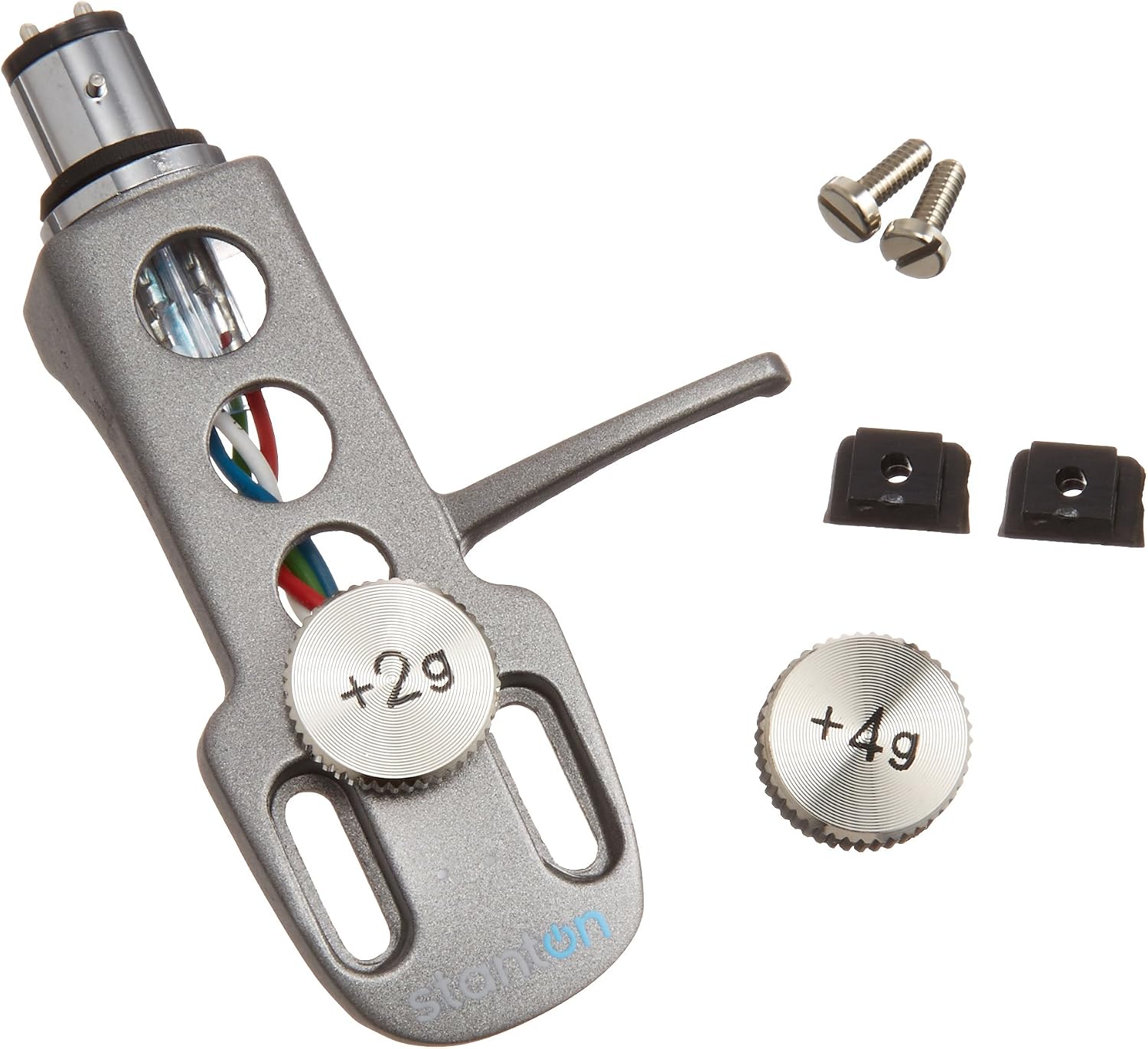

Why would one epoxy the brass plate to the cart? I have lead plates here that simply sandwich between the cart and headshell, and Stanton headshells with a threaded hole for screwing added mass to the headshell for cart tuning.
I'd try it w/o the glue...
