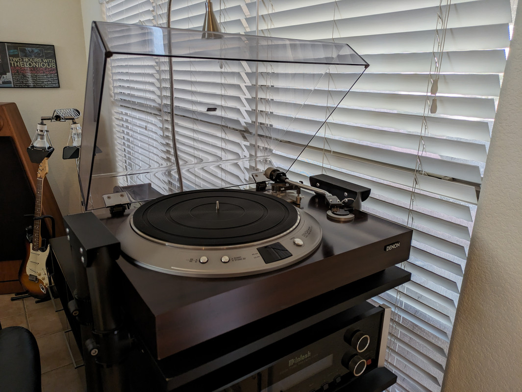

Just acquired my own DP-1200 and am curious if all (or any) you you fine folks still have yours. If so, how has the table faired through all these years? If not, why not, and what did you replace it with?
I have been running mine in my main system since 2010-2011 and it's been flawless, I have a retipped Denon DL-160 on it currently.
I will add that if you have any platter speed issues rotate the speed knob back and forth several times and it will usually clear up the runaway speed problem. If I remember correctly I did clean the speed control with Deoxit once when I first acquired the TT that was about 12 years ago.
Right on...Yup, I did a deoxit to the speed pot and will do so for the start/stop and speed switches when I get to replacing the motor lubrication/oil. After 44-45 years, I'd say it is justified. ;)
Spot on advice. I really didn't want to open up the deck to clean that pot. Rotating the speed knob back and forth several times worked for me too. I like this deck. It's a very solid performer. Right now I'm using a DL 103 cart....it sounds good to me. I've had a few vintage Denon decks over the years...I still use a DP 59L in one system.
